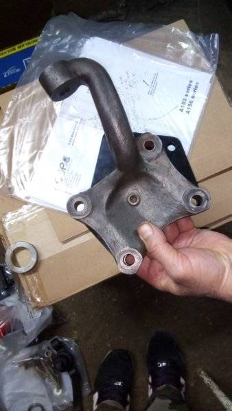

For my Dart 1968 I've ordered wrong SSB-A153-1 from 10` drums to disk brakes conversion kit.
Now I see that I have 9` drums spindles and:
1. Should I look for 10` spindles to be ok with SSB-A153-1?
2. If yes - can anyone share where to get it? Checked all placed I know but with no results
3. Any other options?
Thanks in advance!!

I was at ssb a few weeks ago. They informed me they don’t make a 9” kit. I would imagine a pair of 10” spindles would be an easy grab, and probably less hassle than returning and getting a new kit. Getting a kit for my friends 71 valiant. I know my 67 has 10” drums and I’m just going to swap the spindles, if need be, to run the kit.

but I already have a kit from SSBC and to send it back (from Russia) will be quite difficult :) So the only option I see - to get 10" spindles but I can't find it for my car :(
