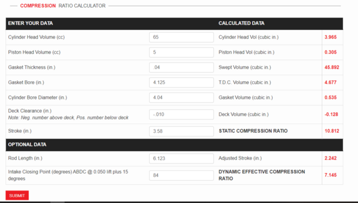

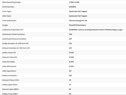

Just after some timing numbers for a XE285HL Comp Cams hydraulic flat tappet cam for my 360 that I am currently building. I am using the KB Pistons calculator to work out compression, it asks for the Intake Closing Point (degrees) ABDC @ 0.050 lift plus 15 degrees, I have the cam specs but not sure if the figure is at .050" ABDC ?? Any help or full timing figures would be helpful. I have attached a couple pics of cam info/specs and compression calculator with my measurements, as you will see using these cam specs from Comp Cams gives an incredibly low dynamic compression. .

Yeah the .050" timing plus 15 degrees isn't that accurate - depending on the lobe profile you could be way off. (Old school easy on the valvetrain grinds vs agressive lobes designed for a .904" lifter).
The timing on the summit description are at .006" lift and probably closer than the 84° you've got plugged into the calculator.
That spec info is off the comp cams site
Yes, but they are advertised timing numbers not timing at .050" lift.
(37° to TDC + 180° to BDC + 69° after BDC = 286° ) there would only be a few degrees between .006" lift and fully closed.
Someone here may have a cam card with the .050" timing numbers. But it will close the valve well before 84° ABDC.
