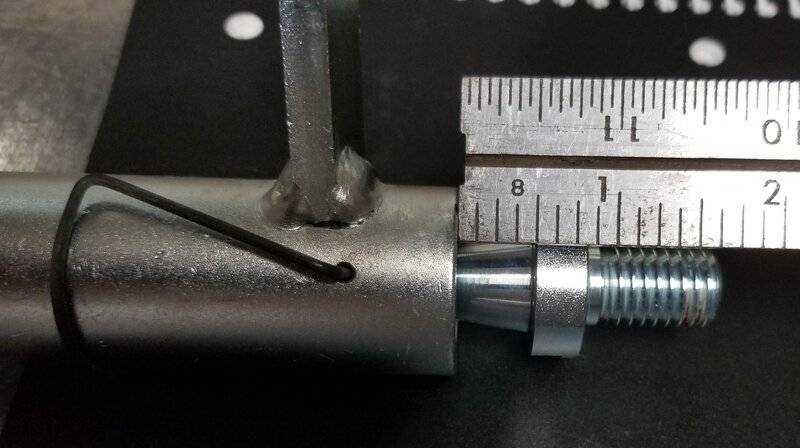

I've got a Z-Bar alignment issue that's driving me crazy on my '65 FS project. This is a conversion from auto to 4 speed, using all original or reproduction parts. The ball stud mount on the inner fender was purchased used from a very knowledgeable guy, installed easily in the factory holes and fits like it was born there. The ball stud on the bell housing matches the BSB478 on Brewers site for '64-'66 small block 273. The bellhousing is the correct 9-1/2 clutch type (10" clutch installed). Front motor mounts are new NOS with correct part numbers on them, the rear mount is a new reproduction from Brewer's. The engine and trans seem to be setting too high, but since the mounts are all new I would expect it to be a bit high, but in range. Not so. The Z-bar is parallel to the frame rail but not level, it sits high on the transmission, so high that I can't get the linkage clip on to the push rod. Pictures include a shot of the bell ball stud before engine was installed.
I have a 65 Barracuda bell but I'm not sure if it still has the ball. I'm at work. The one pictured is the one out of my parts car.
That ball stud bracket looks suspect to me Bob. It looks like the ball is too close to the bolts.
I agree, my bell ball mount is different from your picture, but mine is the same one pictured for 273 small block on Brewer's site:
Can the engine be shifted slightly up on the pass side, dropping the drivers side a little.
If you put it together and the action is free and works properly, maybe you won't be able top get it level. As long as it works right. These cars have some horrible tolerances when built.
The Z-bar doesn't move much, I can't even get the retainer clip on, it's too close to the bellhousing. There must be an incorrect part causing it but I don't know which one. Raising the engine on one side might help (although I'm not sure how I would do that) or a lower rear crossmember/rear mount.
I fixed the problem. I loosened up the two main engine support bolts that attach to the K-Frame. Lifted the right side with a jack and 2 X 6 to rotate it a bit, and then torqued it down to its new location. That freed up the linkage, no more binding. I didn't realize the K-frame holes are oblong to allow for movement. Thanks to Dan Brewer and Crackedback for the suggestion!
