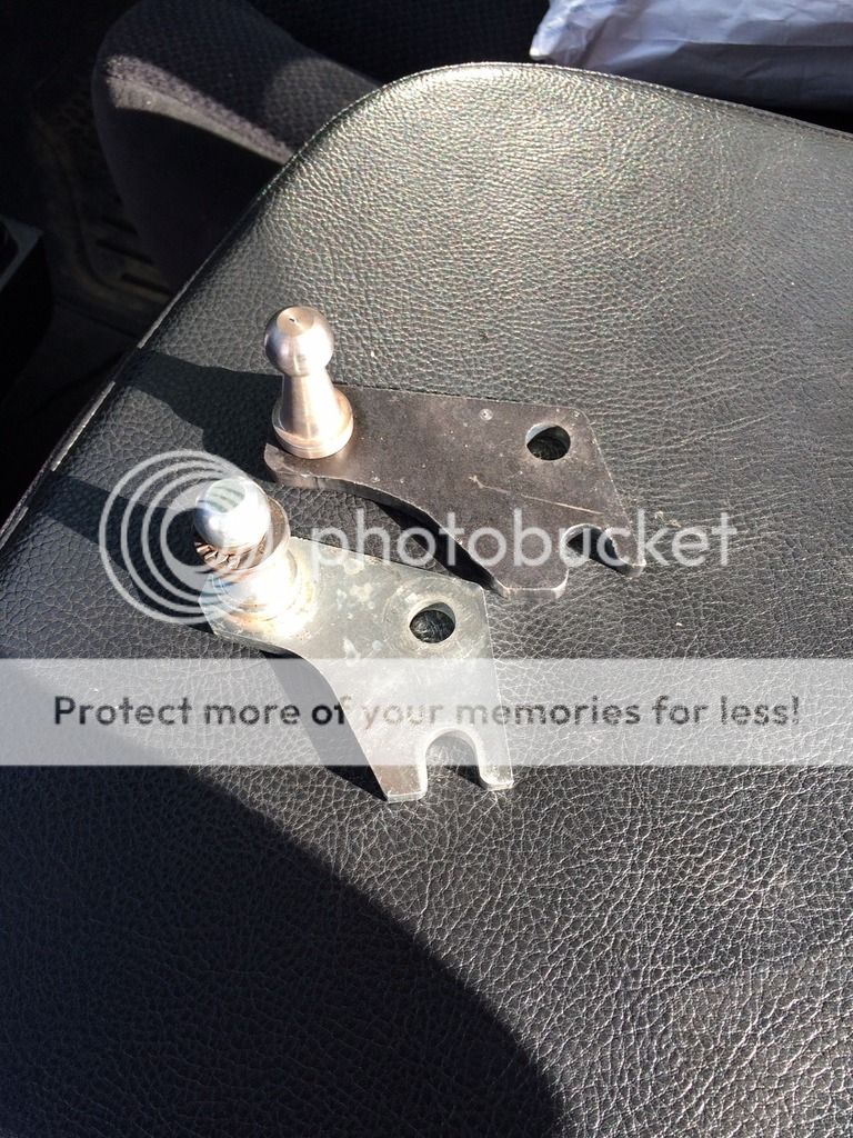

I am working on getting the z bar where it should be and just ordered some parts from brewers. I had the car on the hoist at work on my lunch break. It looks like the ball stud bracket needs to be just short of 1/2" forward. (towards engine) I ordered a ball stud that can just be welded to 1/4 plate.
Plans are to just tack the ball stud check fitment and have it ready in less than 3 tries hahaha.

had my buddy use his computer magic and cut it out at his work on the plaz table.
had to hog out the holes to fine tune it.
Also had to bend the engine side z-bar slightly to align the clutch adjuster.
by moving the z-bar ahead the engine side bar just touches the starter. (and i'm ok with it because i'm not taking it out again!)
