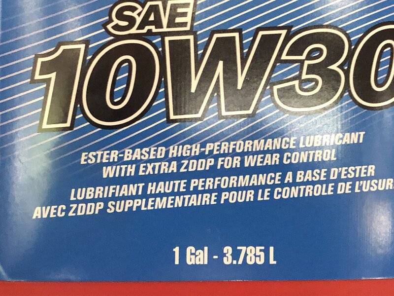

I lost a cam that was running fine for years.....not long after I switched to this oil:
Seems like a winner, right? Synthetic, extra ZDDP ....
Uhhh....
SN is a VERY high detergent oil.
THIS is bad because the detergent wipes away the ZDDP. What sense does this make? Add ZDDP to the oil but also add in detergents that don't allow it to cling and protect?

Do you have any proof that the detergent wipes way the Zn? The Zn is sacrificial. My understanding is it bonds to metals with engine heat but does wear off, requiring fresh oil to start the process over again.
