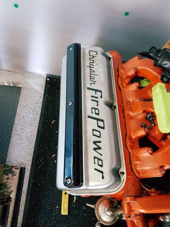

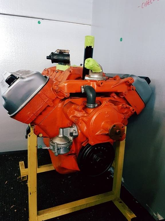

I also do not know what a 392 is worth. I tried selling it before and it was a nightmare. I need your help in pricing this 392 if I sell it. It was professionally rebuilt by the owner of an engine shop for his personal car. He didn't repaint it as it was going in a survivor car. I was told was it was a 1958 392 with a hotter cam. No details on the cam. BIG BONUS - It has new adjustable rockers (see Pictures).
I posted pictures on here when I bought. Here was the response:
"I think you hit the jackpot. As an added bonus the engine has adjustable rockers, which probably means it's a (better) performance engine most likely out of a letter series Chrysler.
Those adjustable rockers, by themselves, often bring over $2K on eBay. Just the rockers. And that's if they're NOT rebuilt.
58N would indicate that the engine is out of a New Yorker. That would mean that the rockers shouldn't be adjustable from the factory, so they must have been added. Another fun fact, the engine hasn't been run with those rockers and those valve covers. Adjustable rocker valve covers had bumps in them for clearance. Those rockers will likely hit those valve covers if they're run as is, even with the factory cam the adjustable rockers hit the non-dimpled vavle covers. The factory adjustable rocker valve covers looked like the one's below, although its not uncommon for folks to use a ball-peen hammer to create the clearance they need as the "bumps" sit under the wire covers anyway.
Also, based on what the heads look like, I would have to say that's either a VERY low mileage engine, or that at the very least the heads were removed and hot tanked. Engines from this era used parafin based oils, and its really easy to tell that from the heads/rockers. Those are WAY to clean for them to have been run with the oil that they would have seen in that era."
I have found only two other like this in Canada and asking price is over $10K without the rockers. I don't know the American market but I was thinking with the CDN exchange rate I could give someone an awesome deal in the US. What do you think the motor is worth?

here my take on your project , it will fit , go for it . it looks very stock on the out side of your hemi , but you remove the rocker covers to show it has adjustable valve train . thats very costly stuff there . it not just a 392 from a chrysler or imp , had got ind or 300 parts in it . would be nice to know the cam specs , but if i remember that should have dimpled rocker covers also to clear the adjustment hardware on the rocker arms . get your trans adapter for it , e bay has plenty of odds n ends to complete your engine , even aftermarket fuel injection that bolts on , trottle body or stacks . even muti carb set ups , or blower stuff . good stuff guy . pics of my buds 38 ford he put a 331 in . made it look like a barn find .
and no hemi is cooler then a early chrysler one , no plastic anything . don't agree with later hemis being as cool looking at all . need i say more , lol . and hey put 392 hemis in these too , and hey are small cars , lol . the blown one is slated for a a40 austin gasser .

in my opinion people will look at it as a core. you know nothing about it.. any receipts to prove it was rebuilt?
392 for sure! Not much different to install. What ever you put in will be custom anyway. Go for the best! You already have it.
To get the most out of the Hemi money wise, have a friend help you start it on a stand....For Sale ....see it run....doesnt smoke....sells for more than an unknown never been run. At least a leak down test to confirm even cylinder pressures. Pop the pan and take pictures of cylinder walls, you can sell with confidence when YOU know the condition of the motor as well as the buyer. I see "built" big blocks for sale for 5K, I feel that if someone can see it run, they would be getting a good deal at 7K. When a seller has it all researched up, ie look up the numbers, I see it sell for much more, but you might be waiting on a buyer. Look at hotheads.com. they have parts.
