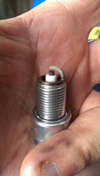

Those plugs look like the center electrode isn't flat and it needs to be flat and parallel to the ground strap to fire correctly. The greater the parallel of center electrode to the strap the greater surface area for the spark to jump across the gap and a better chance the plug will fire correctly.
@RockinRobin I'm curious, by chance have you been cleaning the spark plugs with a wire wheel?

Any chance you have a pic of that plug before it ran in the engine?
Edited;
On their (Brisk’s) website the pic of that plug shows a very sharp electrode and ground strap. You are nibbling the edges off of everything and that is a sign of the very beginnings of detonation. Hopefully this isnt just a stock photo they use.
Is it possible the sharp edges are being removed by the wire wheel he is using to clean the plugs? He stated in this picture on page 1 that he used a wire wheel to clean the plug.
