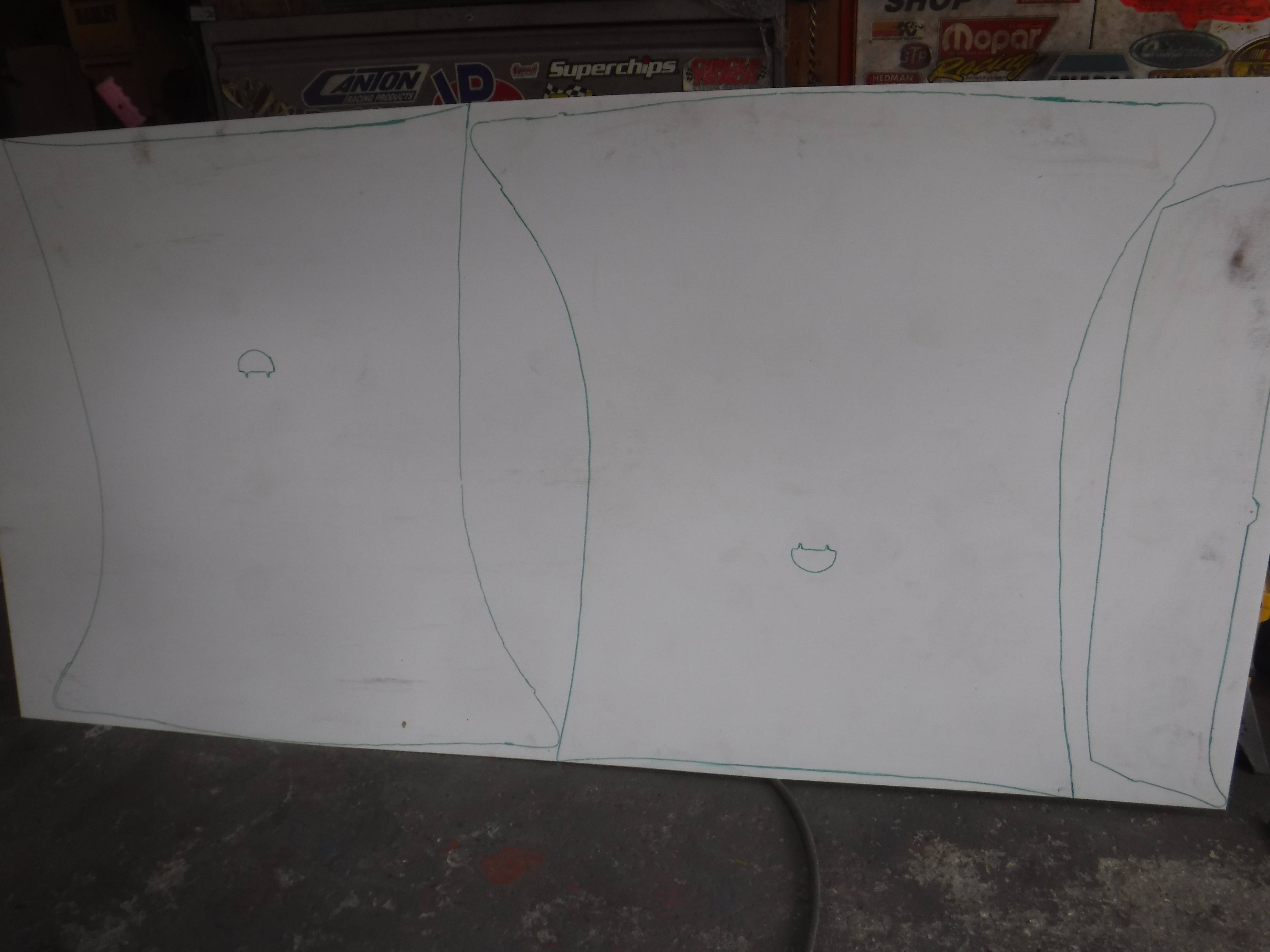

1 start with old headliner for a pattern carefully cutting it apart
2 trace the parts onto the desired material, I used signplast for it's lightweight and longevity
I did two headliners and a trunk lid cover so I spaced out the tracings to have some left over large enough to make that also.
3 carefully cut you material to shape from the tracings with signplast it is a little tricky because it is like corrugated cardboard, you will have to clean it up gently with a razor knife
![DSCF3219.JPG DSCF3219.JPG](https://www.forabodiesonly.com/mopar/data/attachments/1669/1669855-4c567ccbadf65561f81005e7a8fd4cad.jpg)

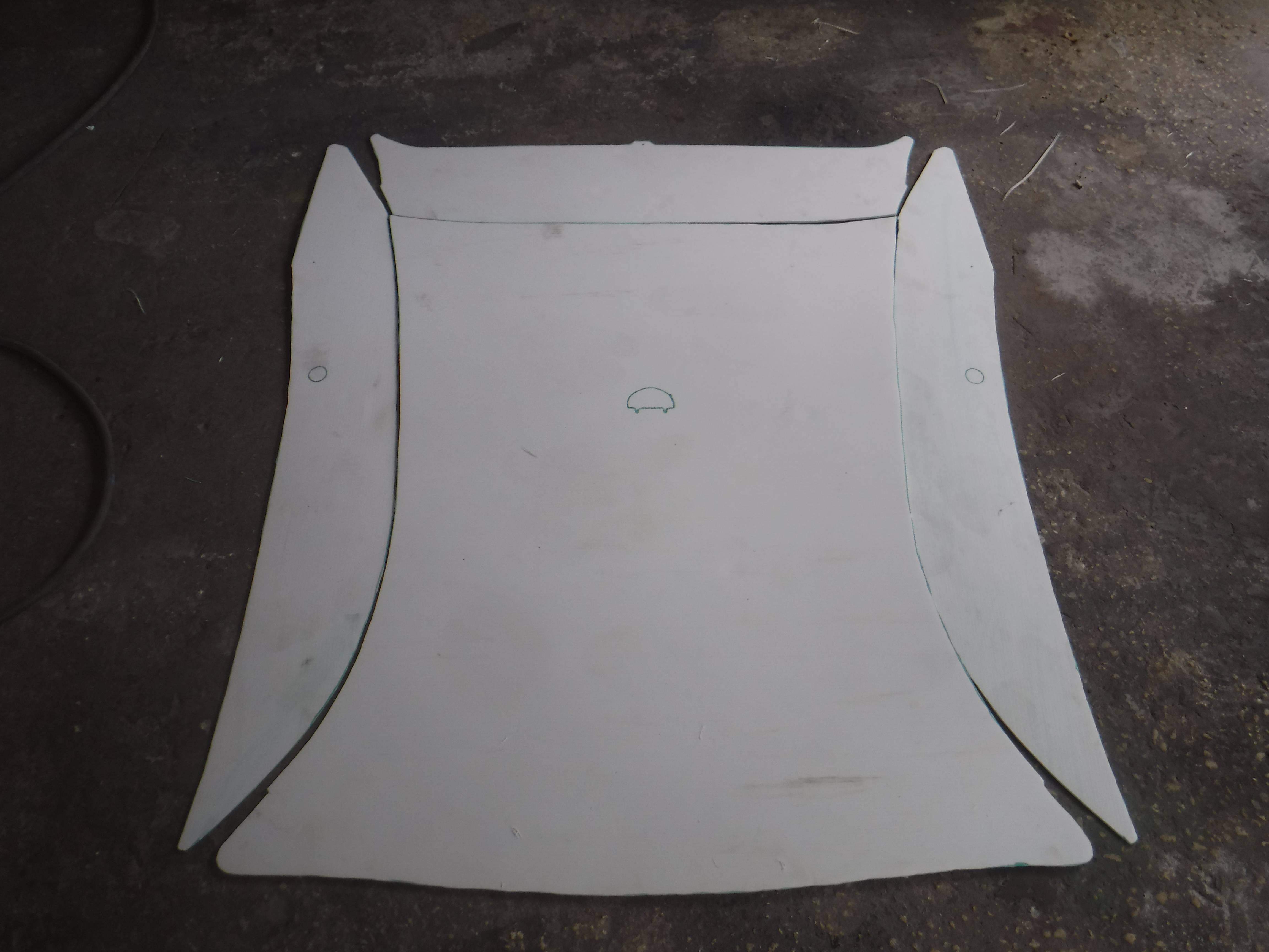

![DSCF3215.JPG DSCF3215.JPG](https://www.forabodiesonly.com/mopar/data/attachments/1669/1669851-ff01dc45875affa84a91481d58fd3d96.jpg)
![DSCF3216.JPG DSCF3216.JPG](https://www.forabodiesonly.com/mopar/data/attachments/1669/1669852-24d169d24acd9f5168cd4934281bc081.jpg)
![DSCF3217.JPG DSCF3217.JPG](https://www.forabodiesonly.com/mopar/data/attachments/1669/1669853-65678f79dd414b5349d29eb3704a14c5.jpg)
![DSCF3218.JPG DSCF3218.JPG](https://www.forabodiesonly.com/mopar/data/attachments/1669/1669854-521a22388760db3b93e6d03c1295ee6a.jpg)
