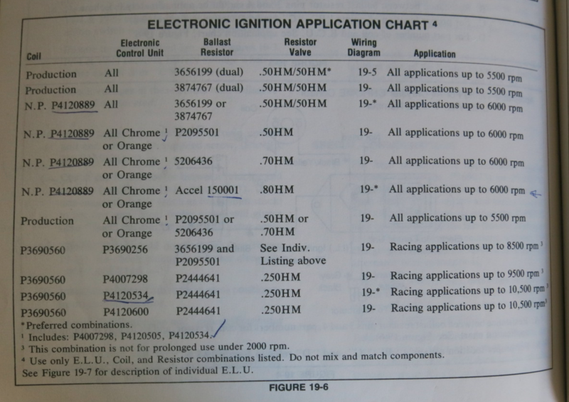

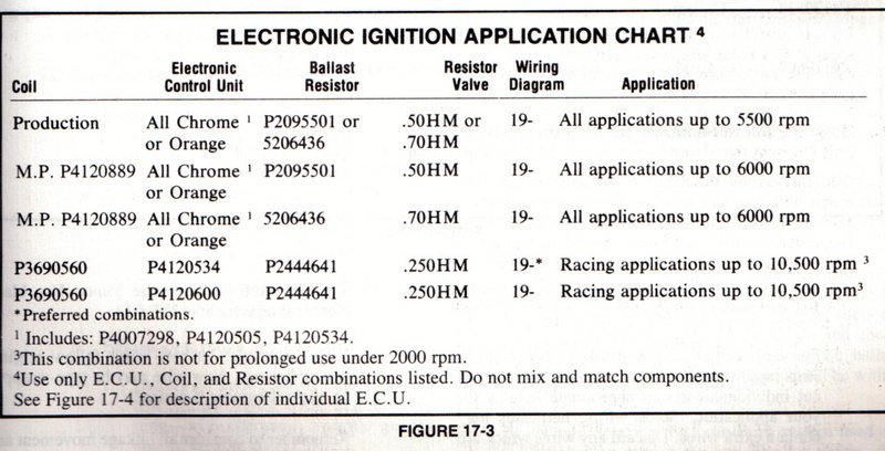

Now sytems with a Mopar HEI is all over the place depending on which box you use. Color does not mean it is a Mopar box, plenty of aftermarket ones out there in different colors. Best bet to see which match for the ballast and coil are is the FSM it has all the specs in section 8. Here are a few examples from older info.
