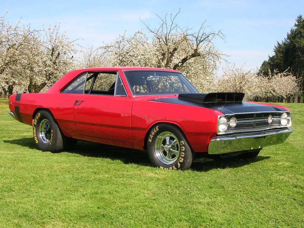

You guys are funny, I'm laughing by myself at work thinking about that as a movie title! I'm not saying the new height is normal because the ss springs will raise the rear. Most likely around 2 inches over a normal ride height. Just put 15" wheels in the back, that's what I did to my dart.
