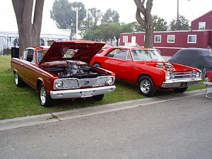

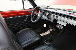

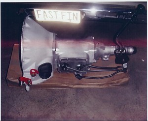

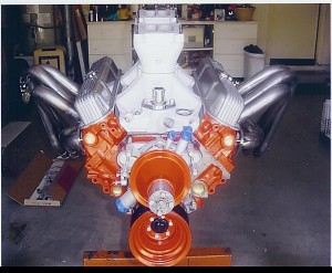

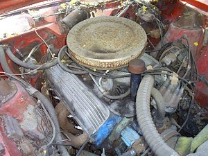

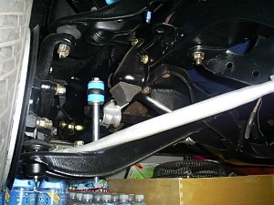

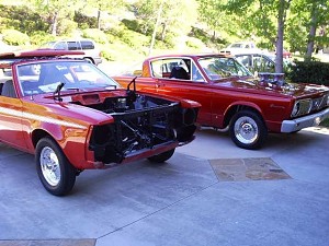

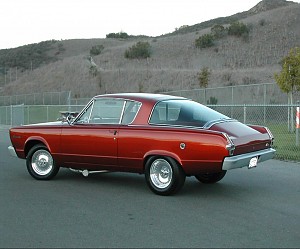

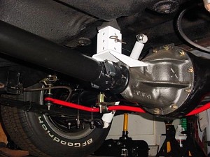

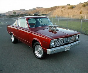

This is my 1966 Barracuda. This was a four year project, the car had a slant six and a three on the tree and was a daily driver. The entire car has been gone through, the Barracuda now is running a 360 c.i. and a 833 four speed, and 8 3/4. The car had added, Fenderwell headers, Flowmaster mufflers, Hurst shifter and linkage, Aluminum bell housing, 833 trans, 1975 360 block, 8 3/4 rear end, Tunnelram, Two 650 Holley's, Eletronic ignition, Bucket seats, "S" model dash cluster with tach and...
