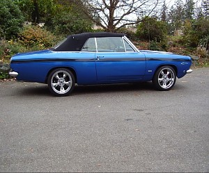

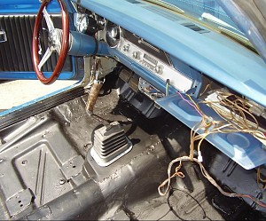

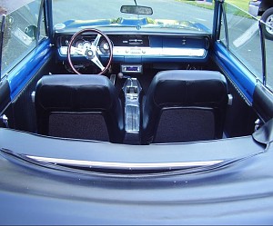

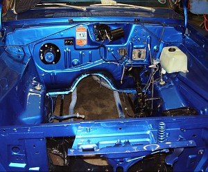

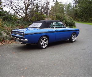

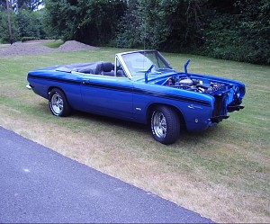

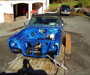

67 vert was d-code 273 2 barrel,console auto,4 wheel drum brakes,81/4 rear end,and homemade dual exhaust.Now 2.5 years later 1971 -360=4 barrel, keith black pistons with 202 j-heads and massive porting,68/70 340 manifolds,alum rad,Converted to a 833 4 speed w/console (soon to be an833 w/overdrive when i find one.)2.5 exhaust w/flowmasters.Big disc in front 11 drums in rear,modern master cly non power,Adjustable tubular control arms and 9.20 torsion bars turned way down,67 gtx b-body 83/4...
