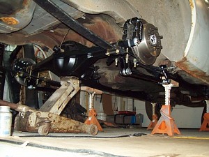

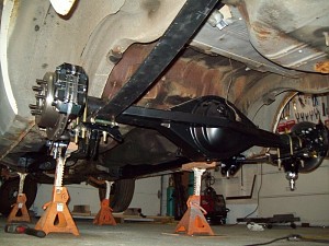

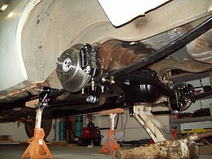

Well, I spent alot on the rear end and Cal Tracs. I plan on keeping this car for the rest of my life and hopefully will be putting some serious power in it eventually and don't want to have to do the rear end more than once. An S-60 would have worked but without a drop out center section, changing gear ratios is a big hassle and an 8 3/4 will likely cost more in the long run than the Strange 9 inch I went with. Add to that the availability of parts and good used center sections for the 9...
