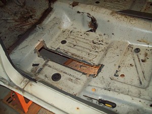

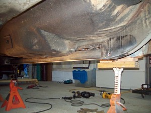

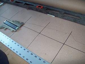

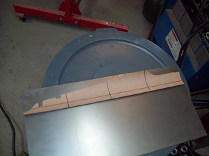

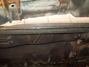

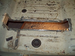

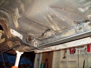

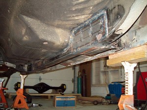

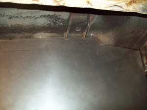

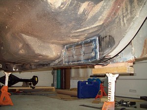

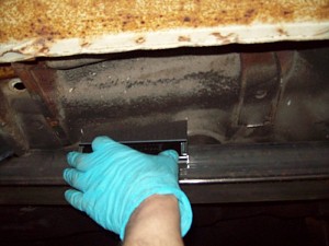

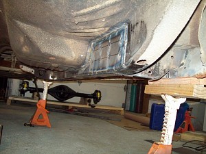

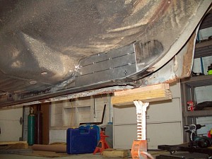

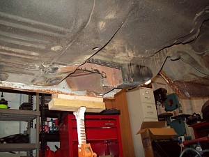

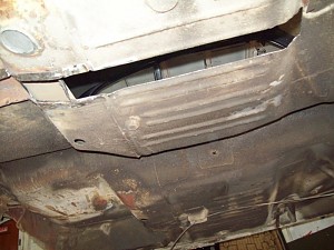

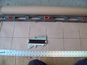

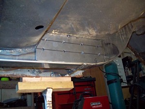

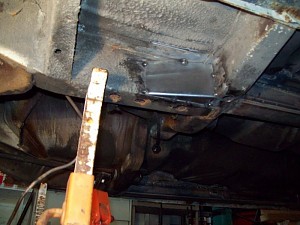

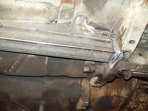

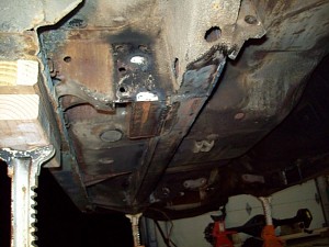

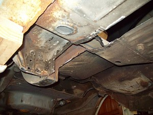

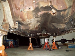

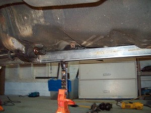

For frame connectors I googled steel tubing and shopped around untill I found a good deal on 2 1/2x 2 1/2x .063 steel tubing and ordered it along with a 1 ft x 2 ft. piece of 16g sheet metal. A little time and effort and I had the floor notched and had the tubes in and completely notched into the original rear frame. Where the connectors go under the front seat area I made paper templates of the floorboard contour and cut out sheetmetal pieces and welded them in to provide a 100% welded...
