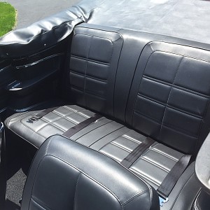

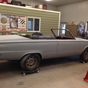

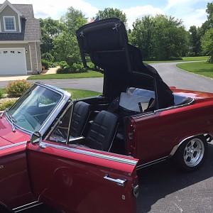

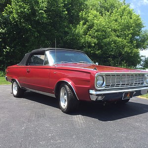

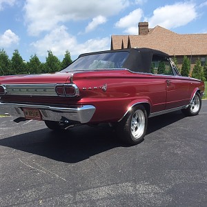

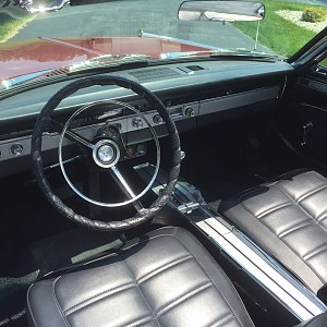

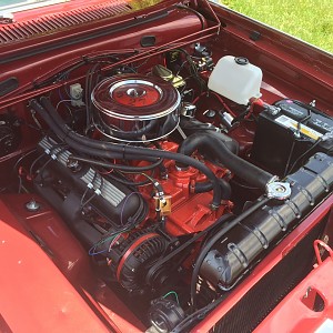

photo 1.JPG 66 DArt.JPG IMG_4259.JPG 66 Dart GT convertible. Bought it as a basket case. Spent a couple years and a bunch of dough but turned out just right.
318, .030 over, 360 heads, small cam and a 600 on top. Added a Hemidenny front end with a power rack.
Cope built 904 with 3.23 gear. Put relays in the headlights and the top switch.
