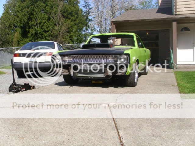

My car is now mini tubbed and springs moved in. I have factory width a- body rear. Rear wheels are 17x11 with 7" bs. Tires are 345/45/17. Fronts are 17x7 with 4 3/4" bs and 215/55/17.

that is exactly what i have on my car except i am running the wilwood calipers on the 11 3/4" rotor. i am a mile from the tie rods. every thing clears lock to lock. the only clearance issue i have is that tire will actually hit the top of the inner fender when the suspension is bottomed out. i dont have any bump stops in yet but when i get them they will fix that prob. my front tires are 26 1/2" tall. i like the look of a big tire filling the wheel well.
