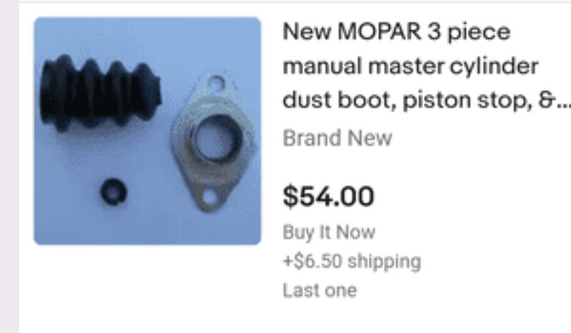

If it does stay, does it take the place of this style piston stop?
Trying to make sure I have everything needed for the install.
My uncle bought a dart that had no master cylinder or pushrod on the pedal so I purchased this replacement and a pushrod from doctor diff. But if I don’t need the other style stop and boot I won’t buy them.
Thanks in advance.
Keeper comes off and the other keeper you show goes on.
Hold pressure in on the piston so it doesn't pop out during g the switch over.
The boot is to keep dust and dirt out of the bore when you press the pedal

Are you willing to share where you found this? I searched with no luck.
The top one is from seller Steve Kirschenbaum. I've bought a few things from him. He and his brother Al have been neck deep in Mopars since the old days. Al worked at a Long Island Dodge dealership. He used to prep magazine cars before the writers tested them. Then he was an editor at Motor Trend and produced a lot of TV shows.
Thank you. I’ll pick one up
