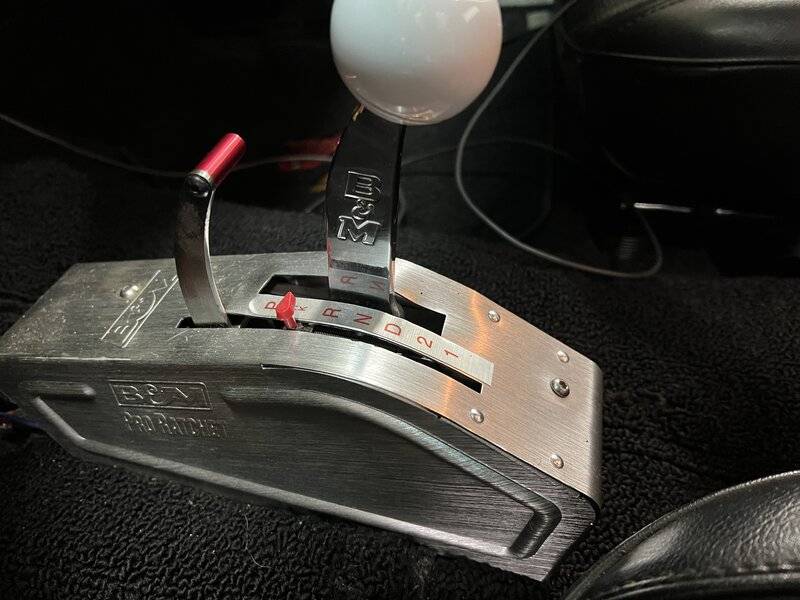

We purchase a 1971 Dodge Demon 4 speed car that had a early 727 auto swapped in (only neutral safety switch not the later 3 pin switch). We need to figure out how to hook up the backup lights. It have a B&M shifter. Any ideas where to start? Would we have to put a switch to the shifter in this case?
What kind of shift linkage are you using on the automatic? Is there a neutral switch on the trans? Pictures?

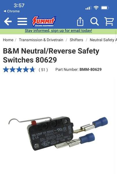

Sounds like Oldmanmopar May have the solution but sounds expensive just to gain backup lamps.
What about a B&M switch (see pick)? $15

Since it's not stock anyway, I'd just add a toggle switch on the dash for the backup lights. Flick it on when needed.
