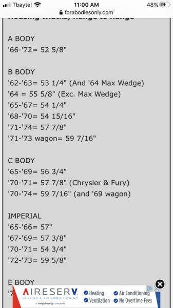

I’m looking for advice on which route to take. I currently have the stock 7 1/4 rear end. The previous owner upgraded the engine to a 360, but kept the weak 7 1/4. What is the best option for an upgraded rear end? Best being affordable and also available with a little luck. I’ve been looking around and 8 3/4’s in SoCal are nearly impossible to come by, especially big bolt pattern A body rear ends. Is it best to find a B body rear end and have it shortened? Also, if there are any SoCal folks on here reading this, where’s some spots that might have 8 3/4 rear ends? Everywhere I’ve called is expensive AF for just the diff. Any help would be appreciated.
You can probably get a B body 8 3/4 under there by moving perches and different backspace on the rims

I found a big bolt pattern 8 3/4 rear end on this page. It’s a b body, but perches have already been moved to suit the A body and it’s only 2” wider, flange to flange. It’s an open diff, but it’ll get rebuilt and upgraded when I can afford to. Thanks for the input everyone!
