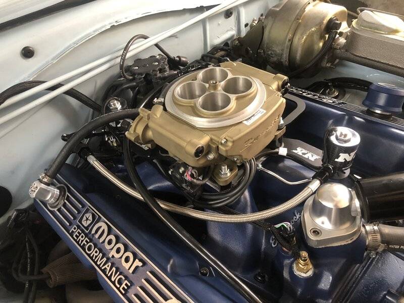

Sniper fuel injection, dual O2 sensors.
14.7 afr at cruise, 12.7 at WOT
My exhaust system is part of the problem with full potential. Shorty headers, Sanderson DD9’s, 2.5” collectors to 2.5 pipe, X-connector, dual 40 flowmasters.
Agree. I'd like to see a full length header, and 3" system, but I certainly understand the difficulty with that in an early A.

I’ll have to weigh the car, but I’d imagine it’s under 3000lbs.
I originally had TTI stepped full length headers but there was no room to work on anything…oil filter, starter, shift linkage, etc
Progress photo. Thank for mentioning the driveshaft loop
Not sure how much overlap is on that cam of your’s but it isn’t the smallest lift and duration I’ve seen. the one in my car is only 515 lift with 234 at 50 thou and 108 Centerline. I can’t image having power brakes as I only get 8-9 inches of vacuum. Wonder what your motor makes.
Have you tried your brakes with the cam you are mentioning?
Cam is a 110LSA
I was originally at .537 lift with 1.5 rockers…dyno numbers reflect this.
I’m adding 1.6 rockers at the same time as the NX kit.
Brakes could be better, but I’ll measure vacuum once up and running again.
I’ve be considering going to hydro boost to improve.

So with 1.6 rockers you're going to be at .573" lift. Do you know if you have adequate piston-to-valve clearance?
Just sayin'
Is the converter tuned for use with nitrous specifically? There's a night and day difference in the difference between a nitrous specific and an N/A converter. Nitrous converters are a lot tighter on flash speed to keep the extra torque from "blowing through the converter."
