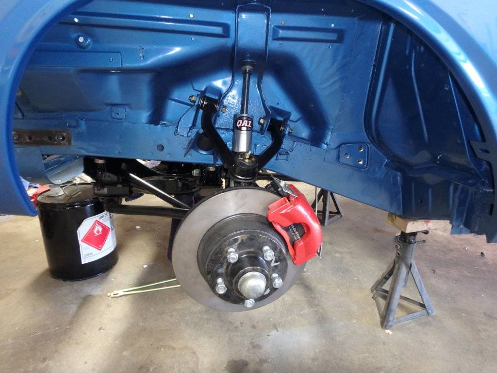

The fronts at 15 X 7 with 225/60-15 BFG's I think the offset is 4.5" It has the disc brake conversion, it is the 78 E body single piston. They do not hit anywhere.

Rear is 235 70r15 on 15x8 with 4.5" BS, front 215 65r15 on specialty wheel 15x6 with 3.75BS. Front has SSBC disc conversion with lightweight (larger) aluminum calipers.
