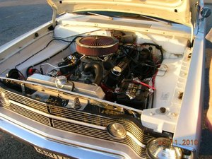

I painted the alum radiator semi gloss black, that I had in my Camaro. ;)
Made it hard to tell it was not stock.8)
