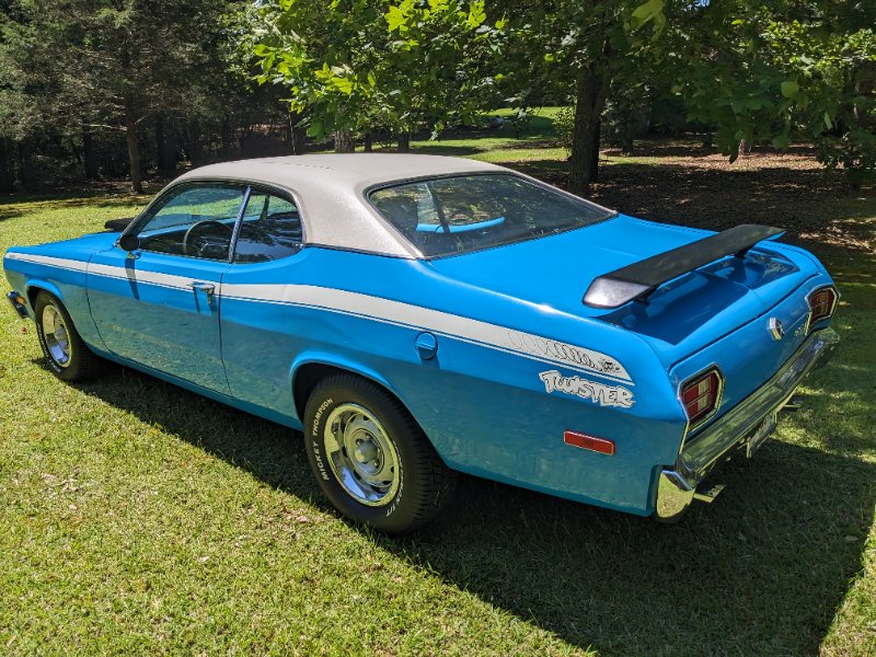

It's a little roomier in the rear wheel well than the Dart, but here is my 1973 Twister with 15" x 6.5" with 255/60-15 rear tires and 235/60-15 front tires:

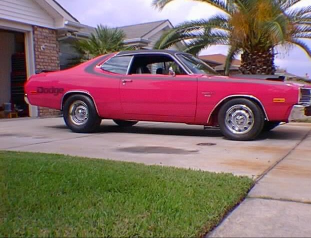

Here is the same car in 1986 with 15"x 7" with 275/60-15 rear tires and 245/60-15 front tires:
I've owned this one since 1981. It originally came with 14" Rallye wheels.

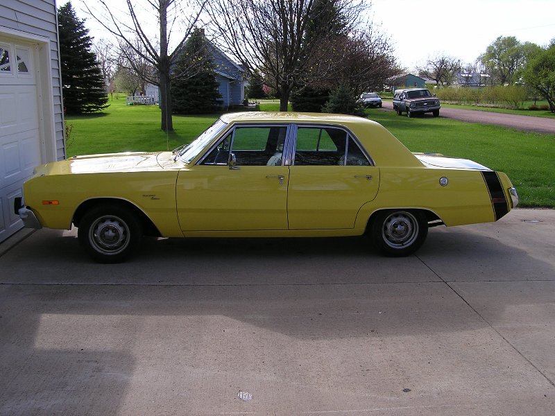

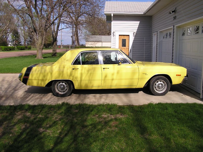

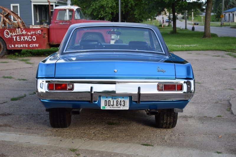

I have 14x6 on the front and 15x7 on the rear with 255/60-15's.

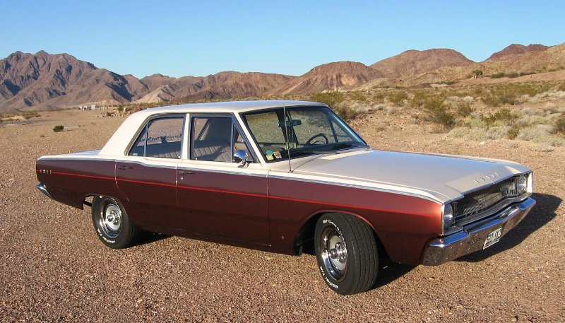

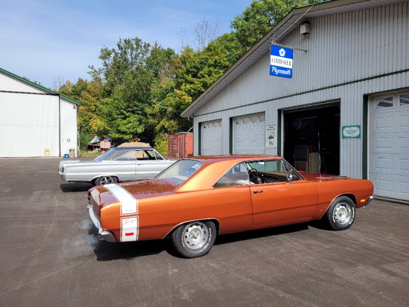

I have original E Body 15x6.5 with 215-60-15 on the front of the Dart Sport. Aftermarket 15x8 rallies on back 275-60-15 drag radials

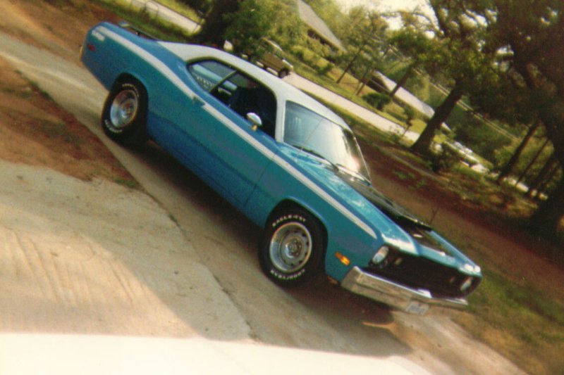

I ran them in the rear of my 73 Duster and they looked about like post 2.
I only have one pic and it's small.

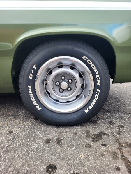

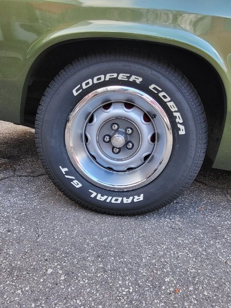

I currently have them on the rear of my 73 Satellite.
The hardest thing about the 6.5 is finding trim rings.
15x7 Mopar rings don't fit.
Fronts are good hight but may do same diameter but 70s over 215/60/15 on E Body 15x6.5 with good used trim rings. When I get new tires. Backs are slightly larger than 275/60/15
