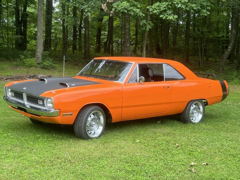

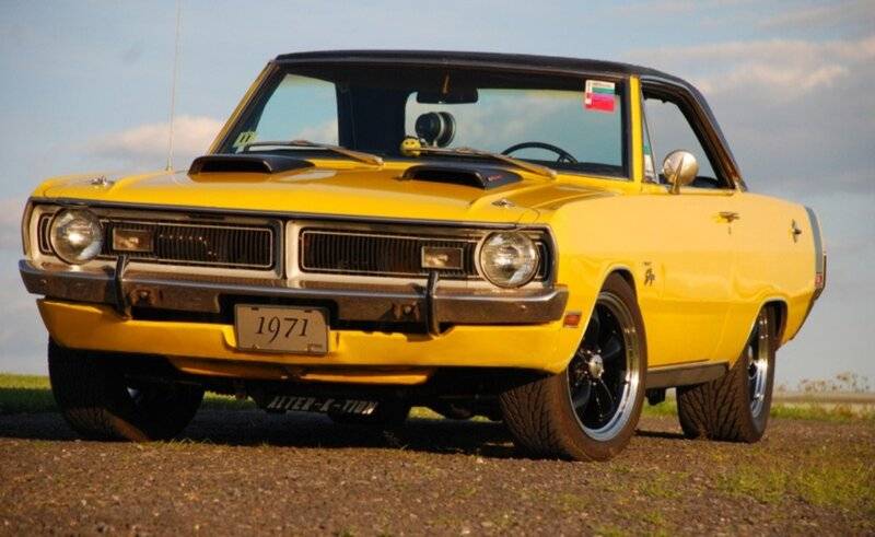

This is the 255/45r17..17x8 w/5.5 bs..so tell me why these wheels rub on the bottom of the front fender..and these same wheels clear with no problems on a
72 demon..I have never heard on 71 and 72 front demon fenders being different except the side marker lights..I’ll have to check out my 71 demon parts car and compare to my dads 72 demon
They clear a ‘72 Dart fender because they’re different than the ‘67-71 Dart fenders.
There’s more information on the wheel opening differences in this thread
Help: 72 Dart Swinger front pass. fender rubbing
And regardless, at 26.1” tall and as wide as a 255 those tires are pushing the limit for clearance of even the most generous A-bodies.

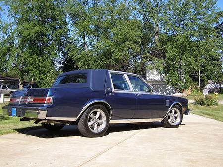

that's the size (255/50R17) I used on my old 5th ave back in the day and am leaning towards on my duster after the big bolt/disc brake conversion.....235/55R17 is a fairly common size (standard tire size on mid '00 mustangs, IIRC)
what rims are those exactly I have been looking for a set of tourq thrusts for my fifth ave but cant seem to find any that fit I am looking to get a set like this right here I just need to know if these will fit without modification to the car and if someone can send a link to them keep in mind my fifth ave is has a stock rear end but I might upgrade to the diplomat police rear end in the future as long as the rims and tires I get mock up
those are OEM Ford Mustang Bullit wheels from the late 90's through 03/04? they are +30mm offset. I used a set of 6061 billet bolt on adapters that were 3/4" thick (the lugnuts holding them to the car fit in a pocket in the wheel between the lug holes). so if you get a set of 17x8 wheels with a +10 to 12 mm offset, they will fit your M body perfect.
As an aside, if you're looking for lower gears for your M body, a jeep XJ cherokee rear end is basically the same width. you'll need to cut off the old perches and shock mounts and weld on new ones, but most in junkyards are chrysler 8.25" rears with 3.55 gearing (auto) or 3.08 gearing (manual)
