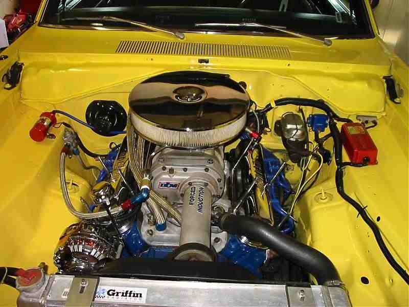

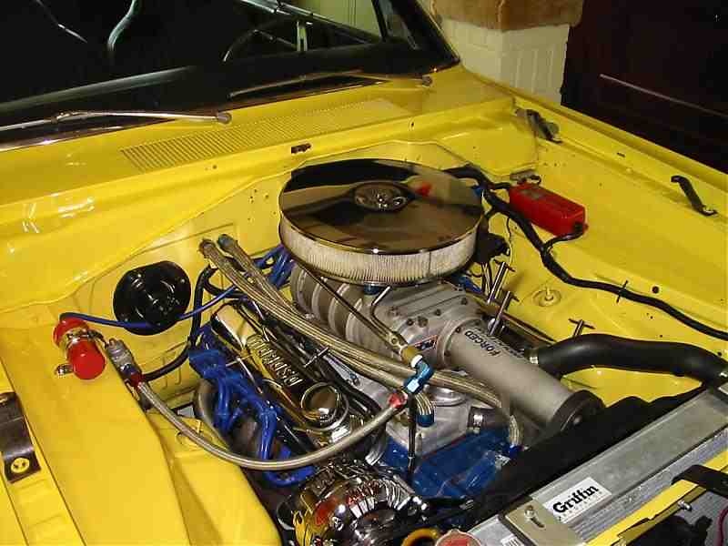

Actually I've had very little trouble. The only problem I've had is the seal behind the pulley popped out on me and got lube all over the place. I replaced it and haven't had any further issues. The blower is a 174 and the intake is a modified Offenhauser dual quad that had the supercharger flange welded in place of the original flange by Dick Landy himself (actually got to talk to him in 1988 when I bought the blower from him for $2200.00). The good thing about this setup is I got the bigger 174 case blower for the small block, the bad thing is that the manifold is not a low profile like the original, hense the fiberglass sixpack hood.

As far as I know that was the original intent but you never know about Mopar applications. My manifold is not low profile because it's originally an Offenhauser dual quad that was modified for the blower. If you have an open six pack scoop on the hood it should fit. I use a low profile air cleaner on a 850 double pumper and it fits, close but it does fit. The best thing is that when you look into the scoop it looks like you only have a highrise manifold and the blower doesn't make any noise until you're making boost.
