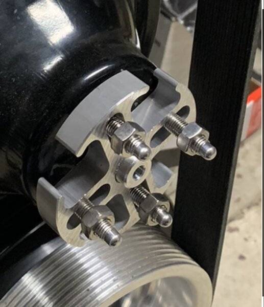

From your picture it looked like you had studs, I was going to ask for part number. Would be cool to find some. Thanks

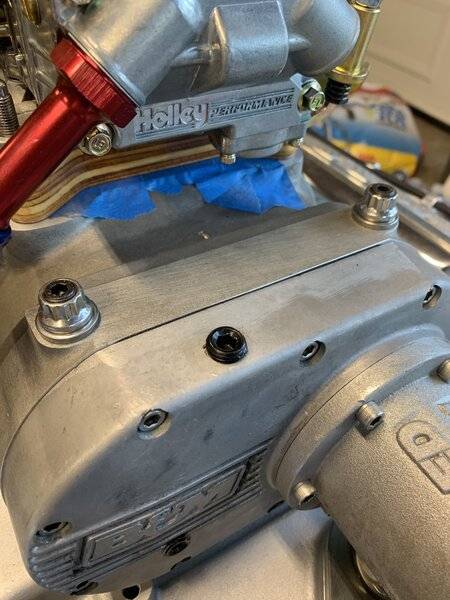

Alright, more fartin around and not much progress, but I found a stud that will work for the first 3. It is this one here:
https://eastcoastspeed.com/item/5759864-716-14-stud-6950-oal-broached
I ordered 3 and got them installed used an ARP 12 point nut & washer.
Original stud on the left, Allen in the middle and the ARP on the right. Hope that helps.

Thanks man! Found them ARP AP6.950-1LGB - 7/16-14 Stud 6.950 OAL Broached-ARPAP6.95 for $8.95 each using ARP part number.

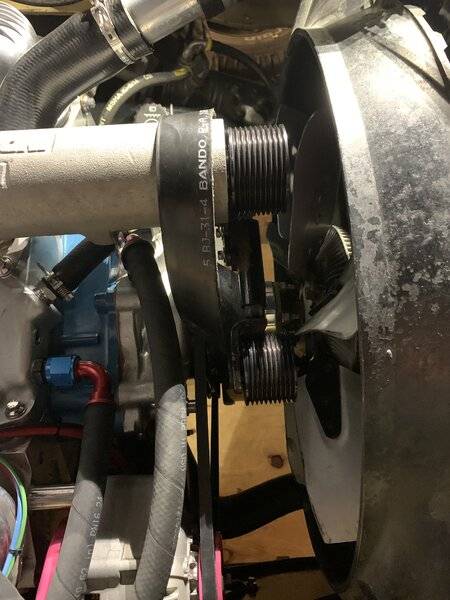

Picked up a 1190 belt today to run the smaller pulley, what a world of difference it made, however I'll need sort out the thermostat housing and rad hose better as it blew the hose off on a hard run and made one helluva mess.
Post pics of your setup if ya can. Odd thing about your radiator hose blowing off, what’s that about? I couldn’t find an 1190 belt so I made what I had work. What’s the PN?

The belt is a Gates 6pk1190 i couldn't get the heavy duty or rpm blower belt in that size so it's just a standard belt.
The thermostat housing has only got a very small lip almost nonexistent and doesn't go around the full 360 degree, ill take a few pics today for you.

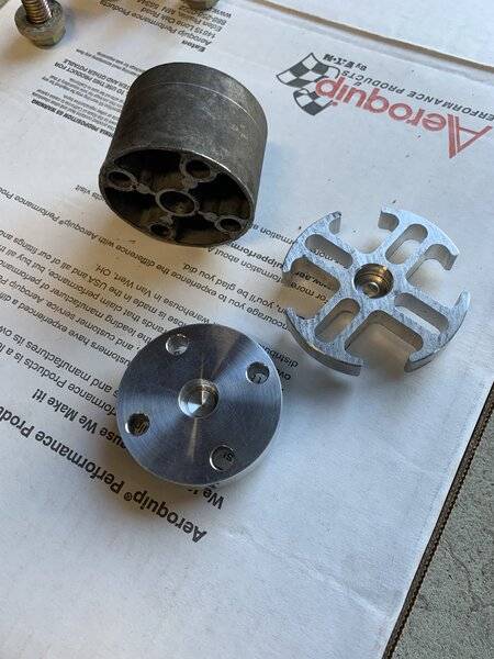

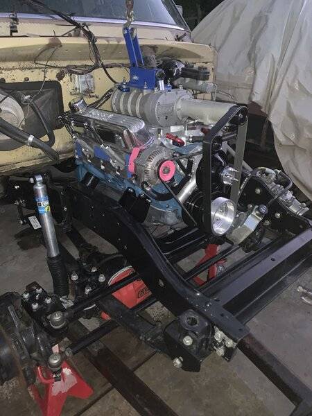

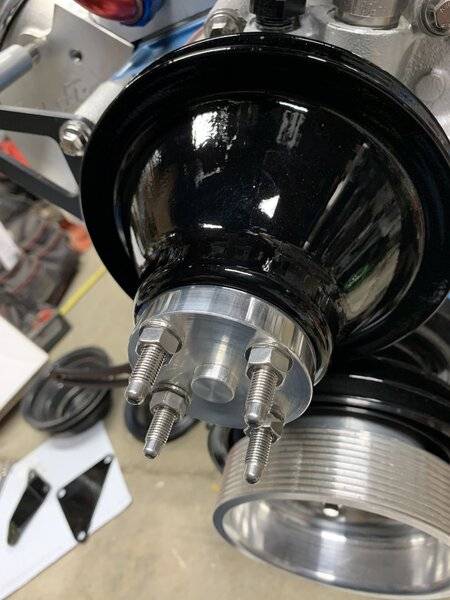

A little more fartin around. I had to space my clutch fan out a 1/2” to clear the 10 rib drive belt. I didn’t like the generic fan spacers available so my brother made one on a lathe at work for me.

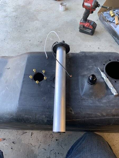

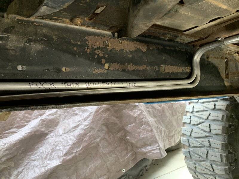

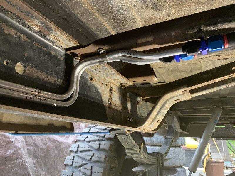

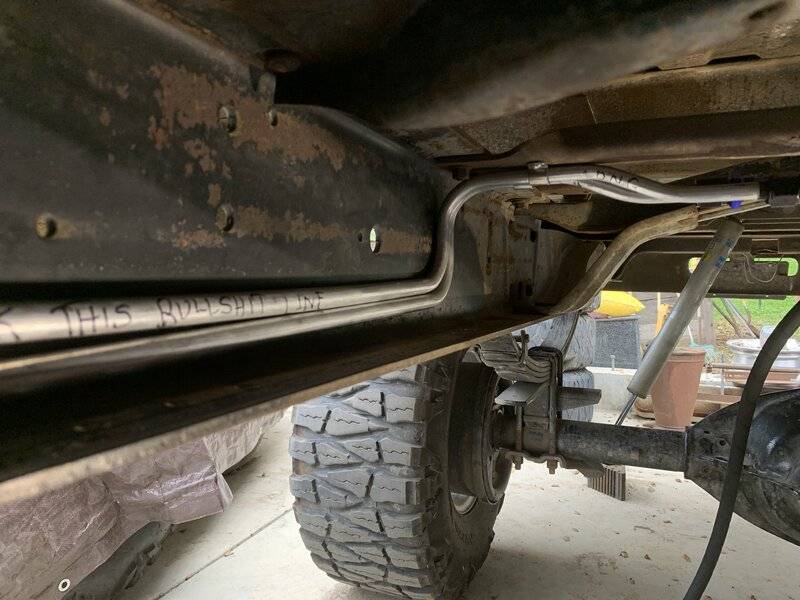

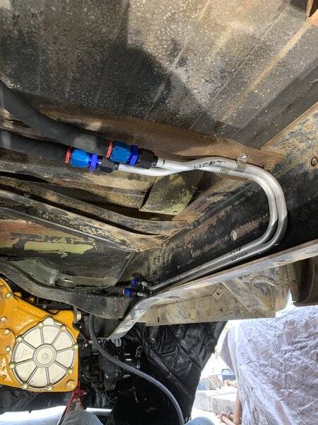

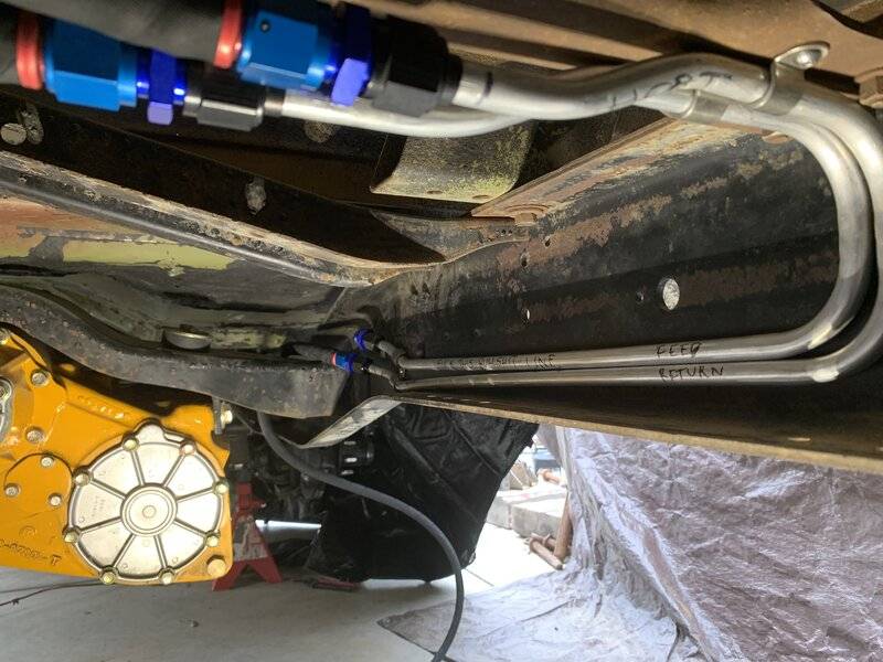

Im using an Aeromotive in tank pump and a universal floatless sending unit. Got some of the fuel lines made. Half way there. I wanted to install the motor this Sunday but we got rain for a week. Would have liked to be driving by Christmas…need to order more fittings. Not the greatest at forming line but this will do, just want it done. Good enough.

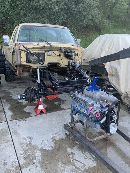

Sick as a dog and laid up in bed for a week but I had to do SOMETHING! Took me the better part of the afternoon.
LOL Nice work on the fuel lines, but what was so bad about them that compelled you to write on them? LMAO

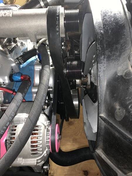

I’m having blower belt issues… the damn thing comes undone. Blows it right off of there. Need to come up with some better belt tensioner or something. I think it’s running out of tension under high RPM. 6,000 seems to do it. I can’t be driving around like a grandma.
Not sure how to remedy this yet.

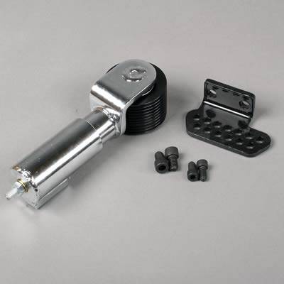

Try tightening the “spring tension nut” all the way, bottoming out the spring. Part on left, in pic.
Then unbolt the “tensioner” from the “tensioner bracket” (part on the right in the pic) and then reassemble with the tensioner as tight as you can manage using the “multiple adjusting/positioning holes. I sort of get the tensioner on a 45* angle (8:00 position) at first, installing only one of the Allen Head Screws (the one on the right (DS) first.
Then pull the tensioner up (the single bolt will give you some leverage) forcing pressure on the belt. Install the second Allen Head Screw. Tighten both up.
Loosen the “spring tension nut”, backing that all the way out. Double nut it at the end or (if your threaded shaft has a hole in it, install a cotter pin and back the nut out, until it rests right up against the cotter pin).
This should give you maximum spring pressure against the belt. Let her run for a bit and check to see that there should be at least 1/4” of “free play” on the tensioner (kinda contradicts the above instructions) but if the belt is new, it’ll stretch out a little bit at first.
You can take apart the tensioner and add a few washers to increase the spring tension too.
I’m assuming your pulleys are running true and wobble free.
