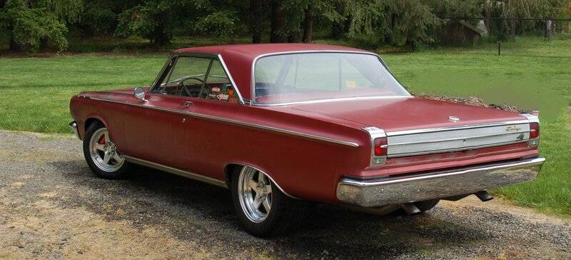

Back when we were road racing A body cars we converted them to Mustang rims.
The wheels on the early A-Body look like American Muscle AMR's.

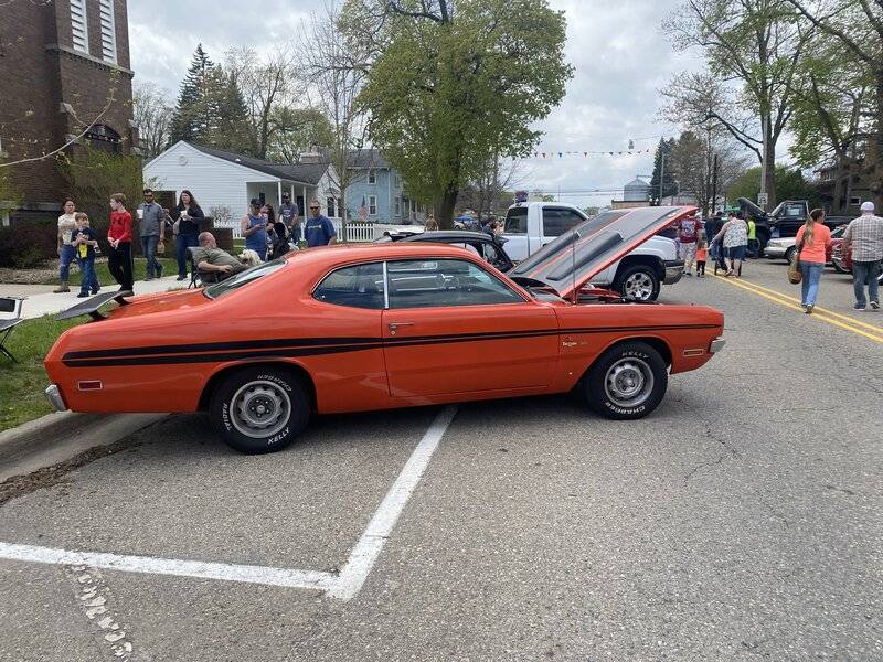

1970 Duster, Trans-Am-inspired "Pro Touring" build
Another "Will these fit?": 18" Mustang wheels
To be clear, that car is a Duster and Demons have a different front fender opening. Could be that the lower front corner interferes and needs trimming. Not really sure. But I know @BergmanAutoCraft runs a wide 18" tire on his Dart and I don't remember him saying anything about having to trim anything.
