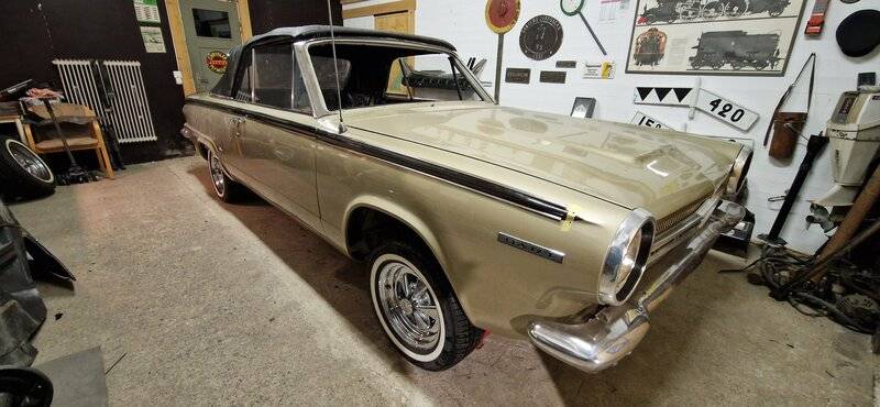

1964 Dart GT convertible

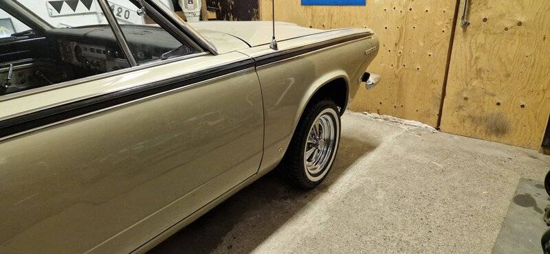

Finally all four side glasses are mounted and adjusted. Next will be adding the wires for the heaterbox.

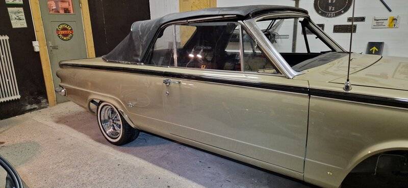

The convertible top boot is added and adjusted. Hood adjusted and the mecanism is restored too.
Finally the convertible top motor is in place. However I need to find new rubber bumpers for it.
What did you FABO member used?
Next step was to assemble part of the top mecanism since I had to drill out one of the sprints that holds the mecanism to the body.
But finally the top is there. Yihaw! :thumbsup:
