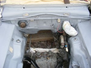

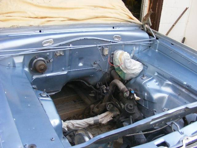

Her,s the job I did on my 66 Dart with rattle can,after a quick cleanup.
