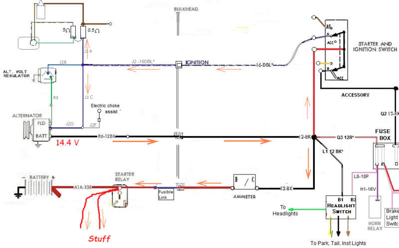

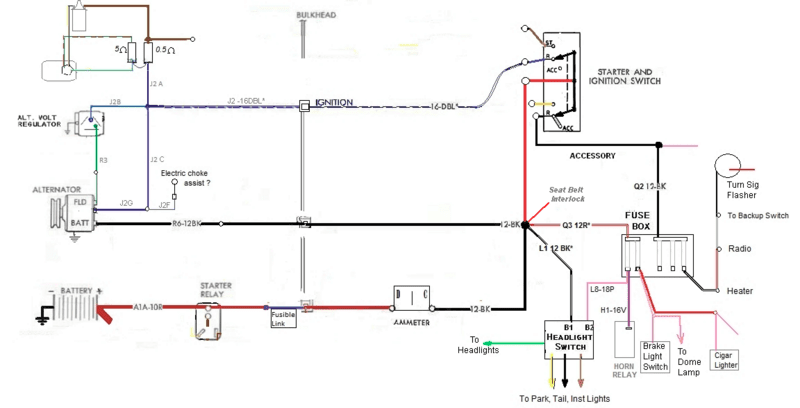

Here's the basic scheme of a '74 Duster with standard wiring. There were some heavy duty options, most commonly on cars equiped with electric rear window defrost grids. The circuit concept is the same, but the main power (from alternator and battery) goes through grommets in the firewall. If you're car has that you'll have to adapt the standard harness as the factory did.
The battery and the alternator output are joined to the other circuits at a welded splice hidden in the harness. That's the solid black circle. Since the battery is connected to all those wires, they are hot at all times. Dome light, brake lights, headlights, horn, all work even with the key off.
When the key is in Run position, the power feed to the key switch is connected to both the Ignition run (J2) circuit and the Accessory circuit (Q2). Wipers are on Q2 but have no fuse. There's a circuit breaker usually in the switch.
The ammeter is a solid metal plate with two studs pressed in. When electrons are moving through the plate, the needle is deflected by the small electromagnetic field generated. No current, no deflection.
If the ammeter studs are loose, the ammeter must be replaced or repaired. Electrons can't jump gaps or go through corrosion without generating heat and loosing power. If the ammeter shows near max either charging or discharging, something is very wrong. Shut down and if that doesn't solve it, disconnnect the battery.

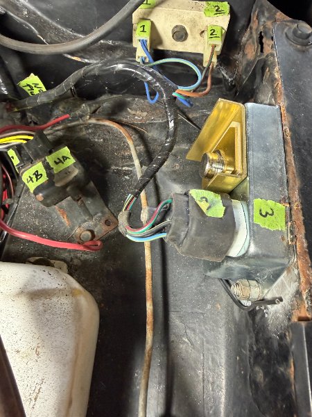

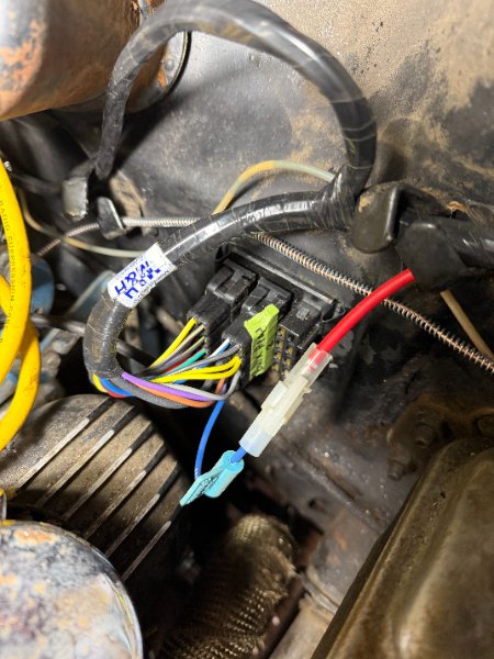

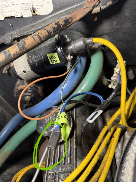

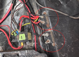

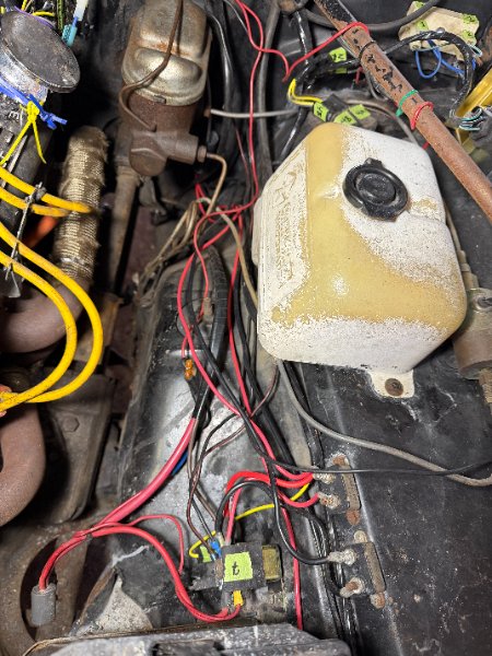

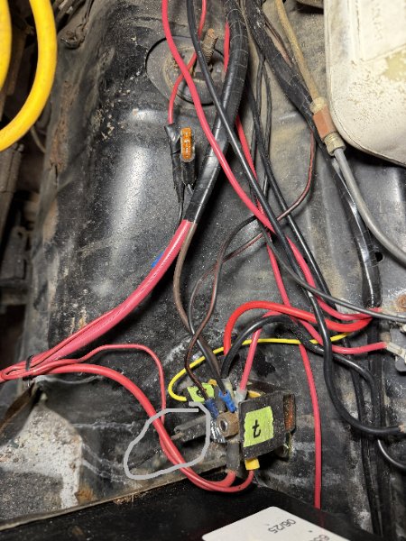

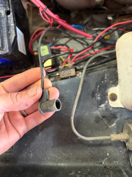

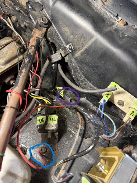

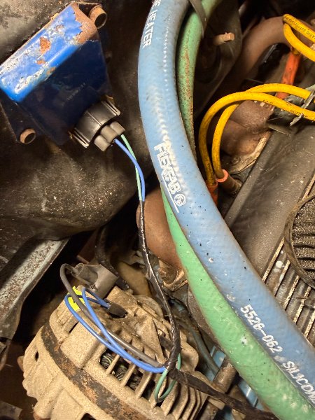

I was able to get there and get some work done on it yesterday, as well as grab some pictures of the engine bay wiring. Before I get into the pictures, there are some updates from yesterdays work. The Ammeter was the issue getting power through the firewall. After those wires were removed from the aftermarket gauge, power began to make it through the dash and rest of the car. We still were not getting spark, so we began to test continuity and use a test light to see where we got power and where it stopped. all of this referring to start sequence schematics that I found in another post on here a month ago when this all started. We decided that we would try the spare ignition switch we have, and that gave us power to the ignition components, but still not getting spark. The ignition switch is also, still not activating the starter and a push button is needed for that (this was working previously when the ignition switch was a known problem). I also tried the reset button on the seatbelt interlock with no change to anything.
On the pictures... it is a mess to look at, but the wiring harness is all new and neatly wrapped. The mess are the aftermarket items that aren't connected into the harness anywhere other than powered off of the starter relay.
In the second picture, the wire that is circled in blue is the ground wire that had been ran from the tach that is now completely unwired. The plug circled in purple was never plugged to anything.
In the fourth picture of the starter relay, the neutral safety wire that is cut is wired into the B&M shifter's neutral safety switch, and was also working wired like this previously.
In the sixth picture, the plug and gray wire circled in green were also not plugged into anything previously.
Last, in the last picture, the black wire with rubber boot that I am holding up was not plugged into anything even with the car running, and comes out of the engine harness below the washer fluid tank. It reaches up to the battery. I cant find that wire on any schematic, but it was on both the old harness that came out and the new harness that was put in.
Most aftermarket ammeters work the same as the factory. Power from the battey flows through them.
At one time these were super common 'cause most Chevies were getting warning warning lights and hot rodders wanted their gages.
So disconnecting should have stopped the power flow.
Possibilities are:
a. You connected the feed wires together
b. The ammeter is a shunted ammeter which internally has high resistance. The power flows around it through an external shunt.
c. Its a voltmeter which has very high resistance. No power flows through voltmeters.
d. Someone connected the ammeter to ground creating a short. A dangerous short to boot.

for sake of testing the wires were connected together. on the gauge front.
Since the car was a race car, a pushbutton start is not surprising. Not a big deal.

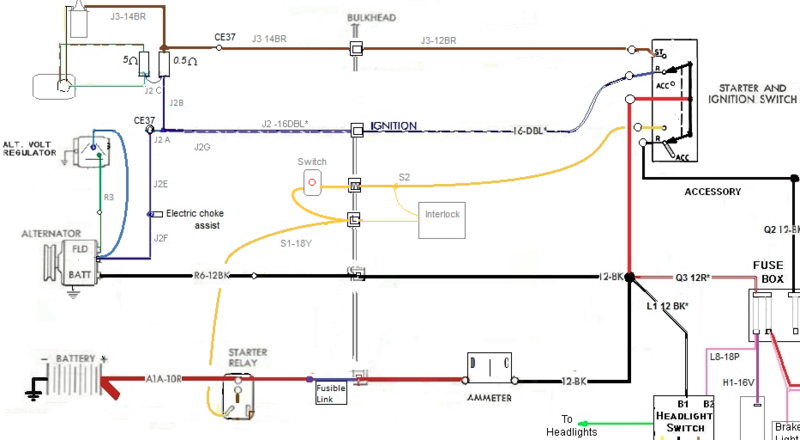

To make the factory set up work, there needs to be power to the starter relay S terminal and a path to ground. Without opening the diagrams, S2 is probably start and S4 maybe the path to the neutral safety switch.
For the ignition to get power with key in start position, circut J3 is needed.
In the bulkhead we see S2 and J3 but not S4. S4 could be for the seatbelt interlock in which case its irrelevant if you jumper at the underhood switch.

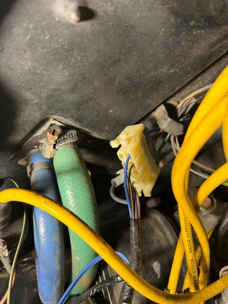

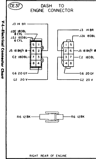

Next photo is the 'engine connector' and I don't see the J3
looks like there's no J2 either
S4 looks like it plugs into the bulk head from the wiper motor harness. is that correct? and the missing J3, that connector is connected how it was on the old harness over at the firewall below the coil.
In general, taking power at that junction is easy but electrically bad.
Some thing really do need battery power. Something like a winch that draws 50 or 100 amps, or the starter which draws over 100 amps.
Most items should get their power from the alternator or as short of a path from the alternator as is reasonable.
Reasons:
Least resistance.
On the downstream side of the fusible link. No reason to pass additional power through this weak link.
Places the branch on the correct side of the ammeter. Anything drawing power from the battery side of the ammeter will show as battery charging. That's just confusing.
This doesn't make sense to me. What brand and model tach is on the car?
I'd disconnect and tape the ground for now.
The other IDK I can't even see it.
The connector with the double is probably for the choke assist. Follow the J2 branches on the diagram and then look at the CE connector charts
The connector in the last photo looks to me like the ones used on the brake warning switch.
The terminal blocks on the fender look really corroded. I wouldn't use them. Replace or toss and/or come up with some new junctions. What's best depends on what you will be doing with the car.

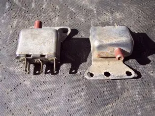

This looks like a circuit breaker
S4 is the neutral safety so it looks like that is taken care of by the splice to the B&M.
You can always make it nicer but seems functional for now.
Reasons:
Least resistance.
A couple things to note for '74
On the diagram J3 designation is used for both the ignition start wire and the wire segment connecting the half ohm ballast resistor to the coil.
The S2 wire branches with one branch going to the interlock box and the other branch going to the override switch. S1 is the normal path for powering the starter relay when the interlock is working properly. If its not, just connect the S2 wires together at the switch under the hood.
(The switch under the hood is set up to disengage when the key goes back to run.)
Revising that to show where the engine connector CE37 fits into the J2 and J3 circuit according to the '74 diagram for a V-8
correct those are breakers and are just wired into the line lock and the fan/water pump motor. the only place these two connect to the car are where they are mounted and power from the starter relay.
