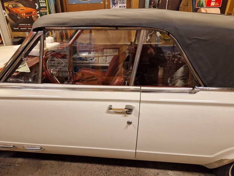

Today me and my buddy Johan did the top. Turned out great with smaller adjustments. Next the stainless steel mouldings around the top. Started to cut the plastic cover to protect the door panels from being damaged by water.
Time cut the top at the bottom and add the restored stainless steel mouldings.

Finally the last small adjustments on the top is done. Next will be to check the top motor and fill the fluid and connect the cylinders to the top mecanism . The exhaust system is in place and the clamps gets here tomorrow.

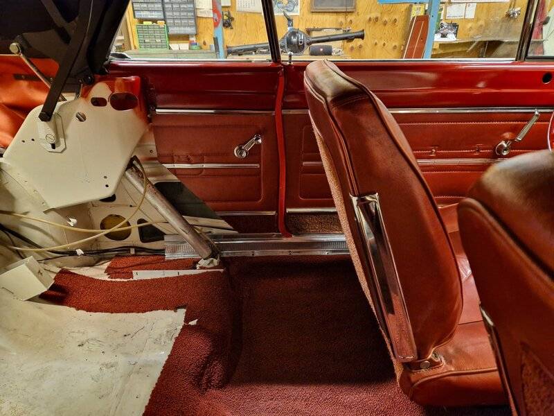

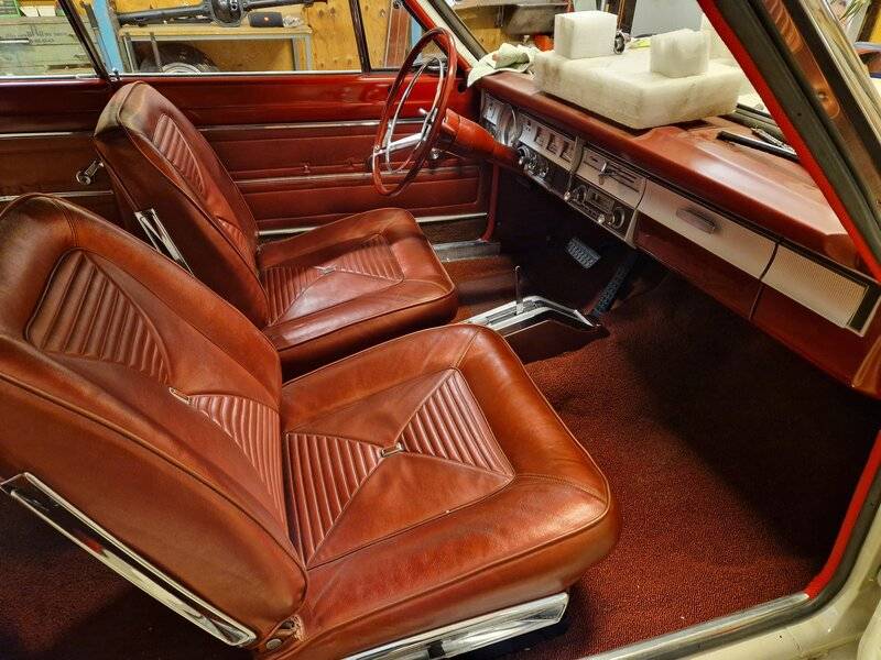

The small stuff is really time consuming! Today I did the last adjustments on the drivers side. Tomorrow the convertible inside panel will go in as well as beeding the top motor.

Finally the car is done. I gave it a good cleaning and washing today. Next is to adjust the lights and have it inspected before the fun starts!
