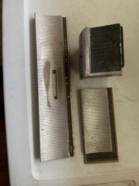

Here you go: 1 end panel, 1 glove box panel without the handle and 1 ashtray
Right now, probably yhe small panel to the right of the glove box on the dash, as long as it doen't have any holes or gouges in it.
