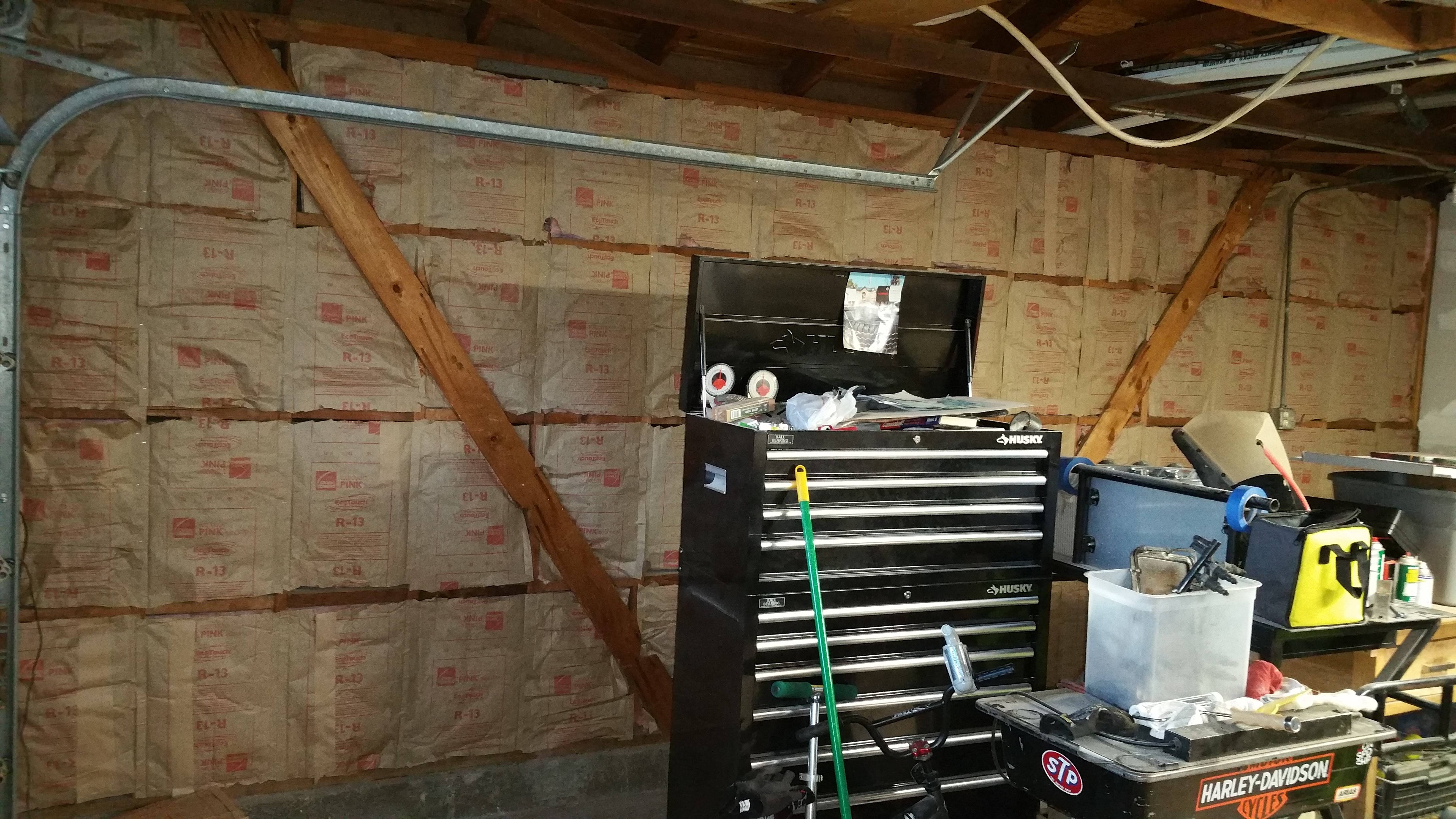

No real update today cause of the garage build, except the car tried to killed me today.
Figured i would drive it into work this morning. At the bottom of my street "bottom of the hill" my drivers side front drum cylinder gave up the ghost and left me without brakes and barreling through a solid red light. Almost T-boned a pickup. Thankfully i was able to pull it to the side of the road and ride the curb to slow me down.
Thankfully no damage to the car or anyone else. Almost **** myself....
