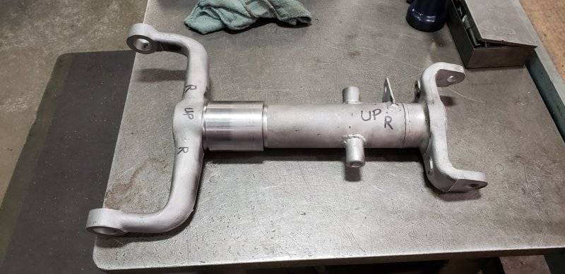

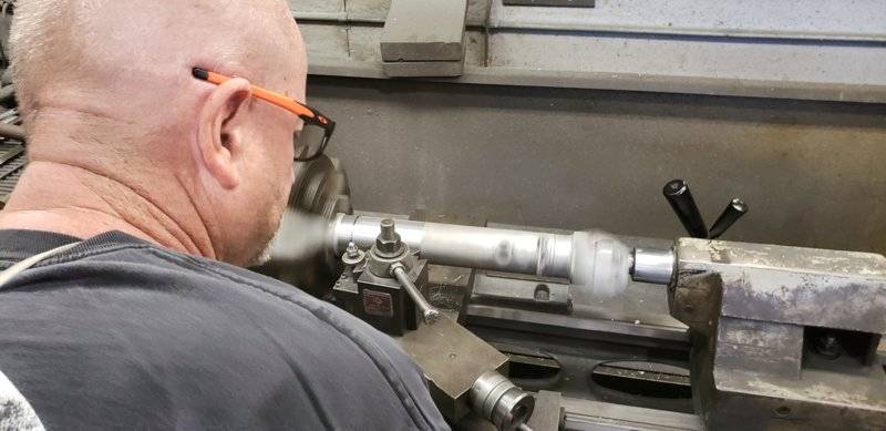

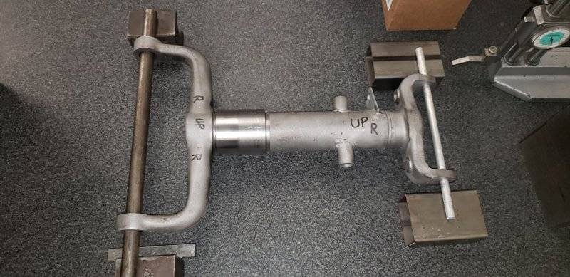

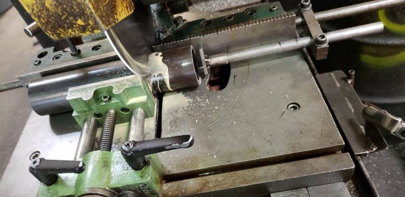

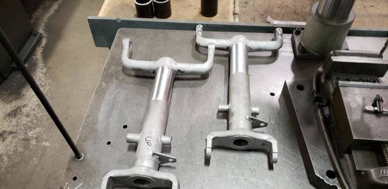

I took most of my only Saturday I have had off in almost 3month and finally got my lower IRS arms cut down. I also ordered a set of bronze race bushings for the Jag rearend. once I have them I can tack the lowers. Mock them up and make sure all my measurement are right then i can do a final weld before moving on to the upper shock mounts before dropping the car on the ground.. Hardest part of this whole rearend mod is finally done.
Got my jag race bushings for the lower arms today. Now I can intall the bushings set the correct length for the lowers tack. Mock up rearend check for fitment before i can do the final weld to the lower arms, then i can button up the rearend. So jazzed at the moment :usflag:
Tinkering at work, going home tonight to set out and tack weld the lowers. Also last night I chucked the bushing in the freezer, should be all shrunk and ready to drop in once the lowers are tacked :D
Got started on the rearend mock up last night. lowers are on, bushings installed. Then I got the hubs cleaned up and ready. Tonight I'll install the axles and hubs, then mount the wheels and cycles the suspension while spinning the axles/wheels/ect looking for anything that might be an issue... I can see the light at the end of the diff swap tunnel... :rolleyes:

Lowers finished welded and coated. Bushings installed and mounted! Starting the upper spring perches this week, flying to Atlanta Ga on Thursday be back Tuesday so hopefully able to fab up a mount by next weekend... Diff is mounted and in solid, still on the fence about the lower torque arms. Not sure how I'm going to make them workable.
