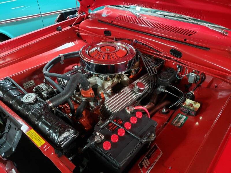

1965 Offenhauser 273!
i'm partial to the chrome 273 charger/commando air cleaner.
i think that's what ma mopar would've used as they had it and it flows well for what it is.
I agree. It's one of the best looking air cleaners ever. Probably too small for a high horsepower motor, but more than enough for a less than 300 cube motor. Shoot, Chrysler put them on some four barrel big blocks in the early sixties - 361s all the way up to 413s (only they were painted black, not chromed) .
nothing stopping you from cutting a big ol' honking hole in the back to free up some HP. nobody'll ever see it back there.

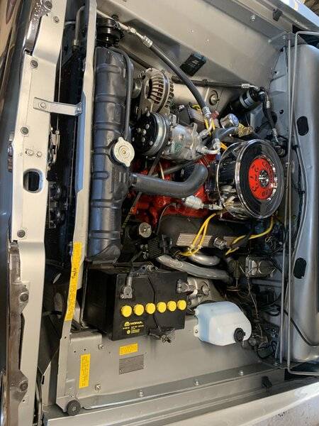

I was working through the oil filter arrangement. With these short headers, what kind of oil filter relocating kits should I use?
Any suggestion?
i *think* you should be able to sneak a stock 90* filter adapter in there. you'll need the one specific to early A's so it doesn't interfere with the frame rail.
if not a "sandwich" style relocater/adapter and mount that puppy wherever you so desire.
