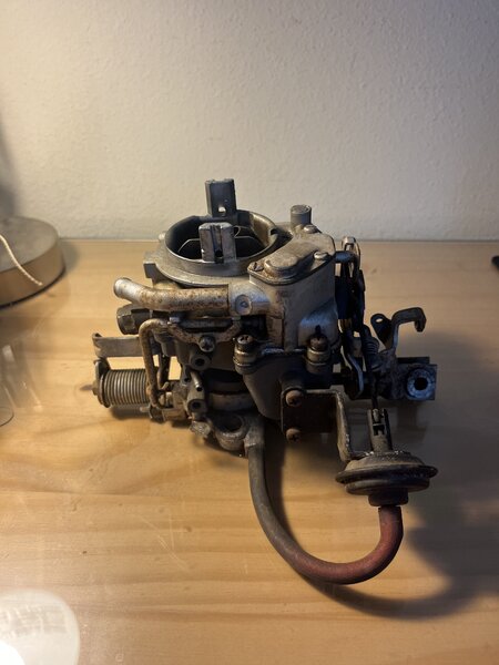

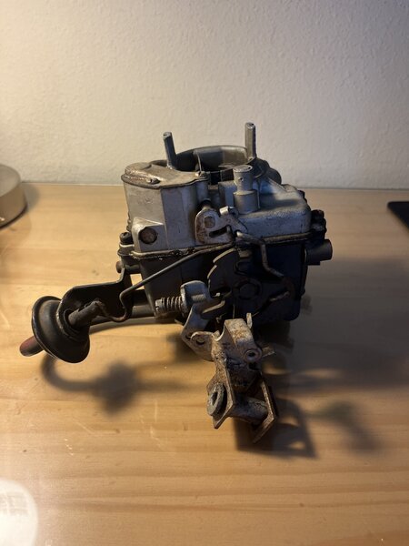

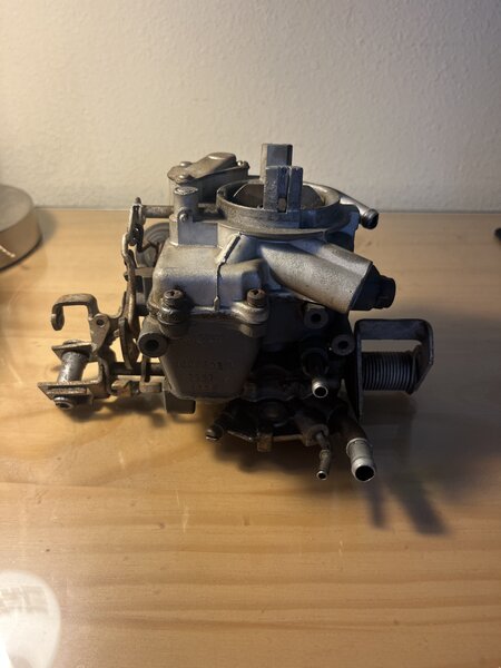

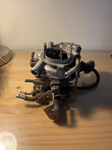

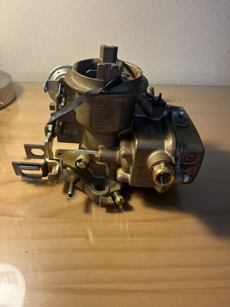

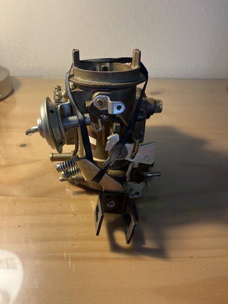

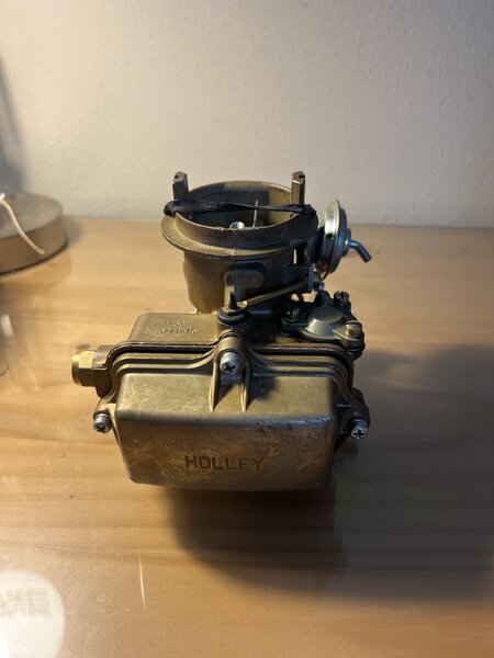

I at the moment, have a 1945 which is pretty crusty and fubar looking, a 6145 (no difference after rebuilding) on the car, and a 1920 that I can’t get fuel flow after rebuilding. I also have no idea what throttle linkage I need for it.
Do you think the weird exhaust manifold I have could be playing any sort of role? It’s closed but I wonder.
Also, the intake flange gasket just has the “rough cut” thick looking one, and a thinner one. Am I supposed to use both, or just one? The car just has the thicker one on it.
I’m pretty sure both the 1945 and 6145 carbs have been refurbished, both have a little sticker on them that other members have said means they have been refurbed by a third party. I just rebuilt the 1920 with a mike’s carb’s rebuilt kit and got no fuel flow.
I’ll start looking at all that other stuff.
pictures. pictures. pictures. these cars are 50+ years old, who knows what's been changed.
if you can't get fuel, check/adjust/re-set your float level.
again, pictures. i have a sneaking suspicion that the motor has some kind of a bitza situation going on.
as to the exhaust manifold, have you checked the operation of the heat riser flap (aka the butterfly in there). make sure it's not froze up and restricting flow.
one gasket only. likely the "rough cut" thicker looking one is the one you want. but bear in mind certain carbs have specific base gaskets and you could be inducing an airleak by mixing and matching pieces around.
I'll send some pictures when I run by my house today. When I DO remount the 1920, I'll adjust the float level and see if I can't get fuel flow after adjustment.
I've looked at the service manual now I know where it is. I'll check at my house for that counterweight moving about a 1/2" CCW.

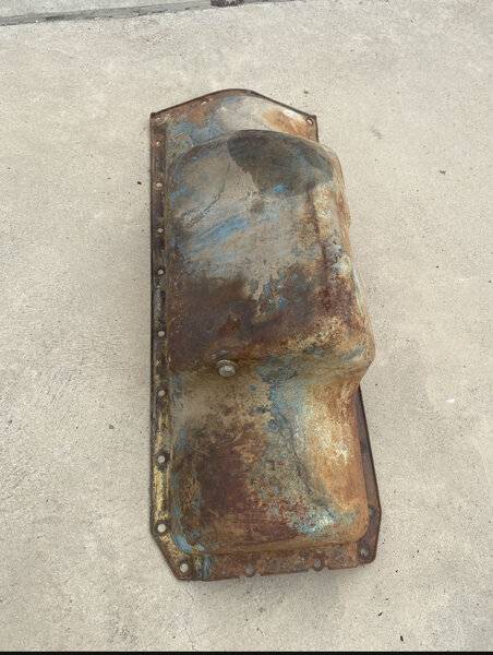

Turns out the oil leak was from a cracked oil pan. One of the many previous owners put in a slant from a later car that rubbed against the K member and made it crack in the front and another in the back. Gonna need a new oil pan or dent in this one and get it welded. Fun fun fun.
is the engine original to the car or is it from a later date, thus explaining the pan situation?
i believe that the early body takes a unique pan. @MidnightSwinger or @RustyRatRod would be able to confirm
Yeah it’s a later engine. Blue block and 5 freeze plugs. I know the pan I need, just don’t have it. It’s the pan without a number stamped on it. Bulge in the middle. Don’t know where to find it either. There’s a guy near me selling the oil pan I need, I can only hope he actually has it.
The oil pans for the early A bodies are all their own. Nothing else will fit without making contact. .......and they are kinda hard to find.
Boo… Hoo…
Sucks there’s no aftermarket oil pans for the 225 on the early A bodies. Does anyone have dimensions of the pan? Might make my own. Hah. Ahahah.
Also, the early a body pans are not the only pans with no number and they all pretty much have the sump in the center, except the truck, so be very careful when looking for one, because there's only one that will fit.

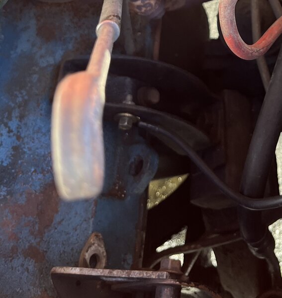

Does this look right to you?
a follow up question: does it have to correct motor mounts to keep it off the frame? and are the insulators in good shape?
it'd be terrible to get a new pan in there only for the same fate to befall it.
(i know this doesn't help you with sourcing a new one)
Oh ****. I got no idea. Didn’t even think of that. Maybe? I’d need a reference. I’m guessing the insulator is a rubber piece?
edit: here’s a pic. It’s dark out, so a better one will have to wait til tomorrow.
I cannot tell 100%, but I don't think so, no. Maybe if you could rotate 90 degrees clockwise and get a picture from that side I can be sure.

It's your car. Rig it up however you want to, but it's the wrong pan and that's the whole issue. I've been through this a long time ago and the sumps are not the same, front or back. I have three early A pans including the one on Vixen, the one on her original engine sitting on the floor and the one for the new engine I have going together. Trust me. They're different. There is ONE other pan that CAN work, and does work in everything else with no modifications (except trucks) but, you guessed it, requires a "little" massaging rot eht early A, but those pans are just as hard to find. WHY any company will not make one is beyond me, because they would sell. ALL they'd need to make is TWO pans. Make one to fit all the car chassis and one for the trucks and that's it, but they won't do it.
