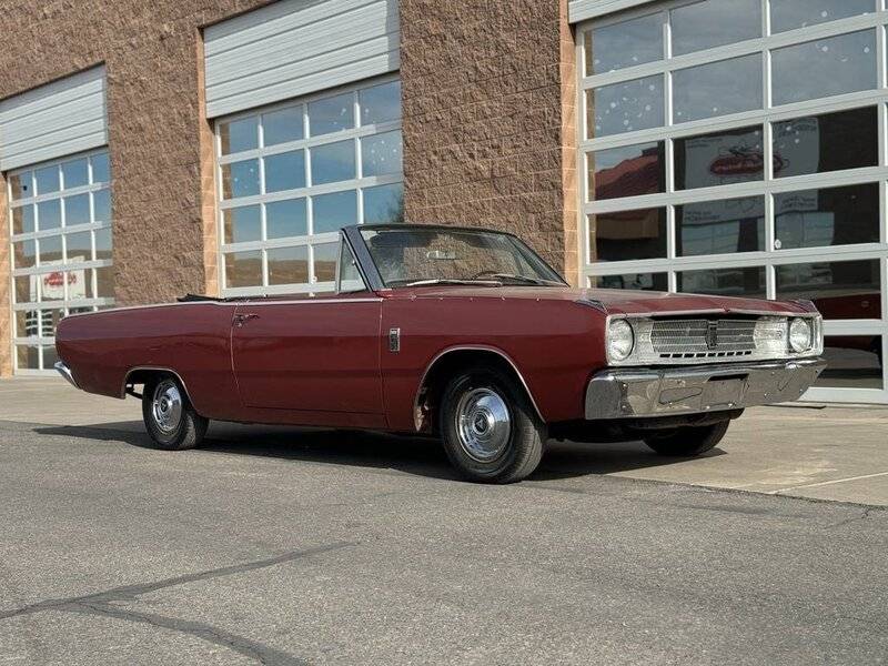

Hi, just joined and introduced myself in the welcome forum. Just, literally just, bought a 1967 Dart GT Convertible. I was a mechanic in the 80s before college and have tinkered with cars since then, but no real work. I usually buy new since 1999 and have a decent grasp about how modern cars work.
Here's my plan, please let me know if this ain't going to work, I think I'll buy a cheap/auction 2015-2023 Challenger with 5.7 Hemi, complete car, and swap everything over. Keep in mind I'm a mechanical engineer and have extensive electrical engineering knowledge and have my own CNC machine shop; I've worked professionally as a metal fabricator as well. I want to bring over everything I can, tastefully, not just bolt on, but there's more on that later.
I plan on using the engine/trans, radiator, heating/A/C, infotainment, ABS, sensors, parking sensors. All that jazz. I know I'll have to modify and completely fab all this stuff in, not a problem. Just want some hard truth here if it can be done. I don't mean mentally or physically, I mean with all the electronics and controllers in that car and sensors can it be moved over? I think the only thing not coming over is Air bags, but I'm sure I can get a programmer and turn that warning light off?

I haven't had a car painted since the 80s. Anyone know what good paint and bodywork cost, just a general guesstimate. I will give them a fully stripped body with everything removed. Body looks pretty good and straight, almost no rust (from talking with the seller) car should be delivered next week. I'll want them to dip or sand blast the car.

ah, i wondered who picked up that off of the CL... nice.
anyway, "good paint & body" is wildly subjective. anything from a production shop is gonna run probably 10K plus, and work from a top quality entity that's known for vintage work or higher end paint jobs is likely going to be double that or easily more.
dipping a car in CA is expensive, like 2K+ kinds of dough. blasting something is usually about half that.
Are you stalking my car???? LOL
