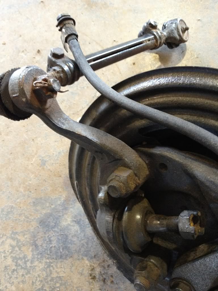

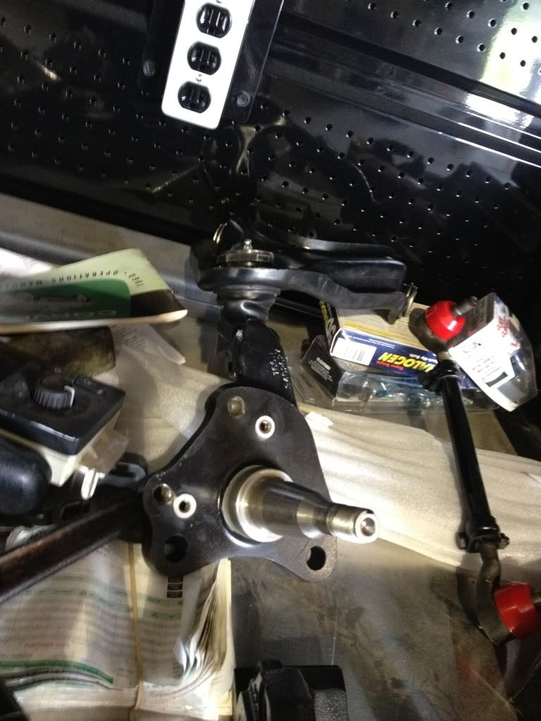

Got a ton done today!!!! I pulled some disc brakes off of a 75 duster and gutted them, sandblasted all the pieces, and paint/clear coated them.
Pictures
Drivers side done!!!

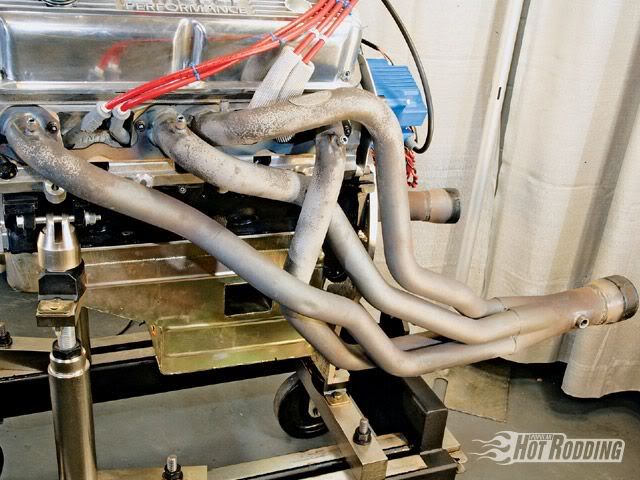

B-Body headers different that A-Body?
If I got the brakes off of a 75 duster, which brake hose do I use? A 67 dart with discs or a 75 duster with discs?

I had a feeling the headers were different, since they were for a labeled "b-body", but when I bought the pan it wasn't labeled for any specific body style, and I did have it mounted in my 73 b-body.

Finally got Louie's drivers side brake conversion done. This is the first time Louie has stood on it's own off of the ground since I have had it. I only have the drivers side done so far, but I am tackling the passenger side tomorrow.

Oil pan will work, just called a local shop. Headers are still a mystery. Here is a picture of them.
Hmmmm that means I will have to sell them. What is a good combo with a 400 ish horse .508/.294 cam as far as headers and exhaust?
