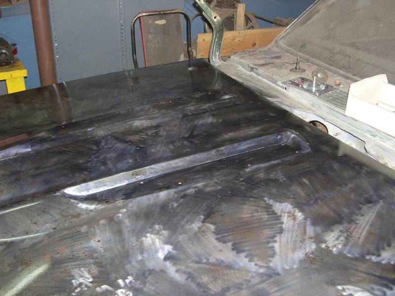

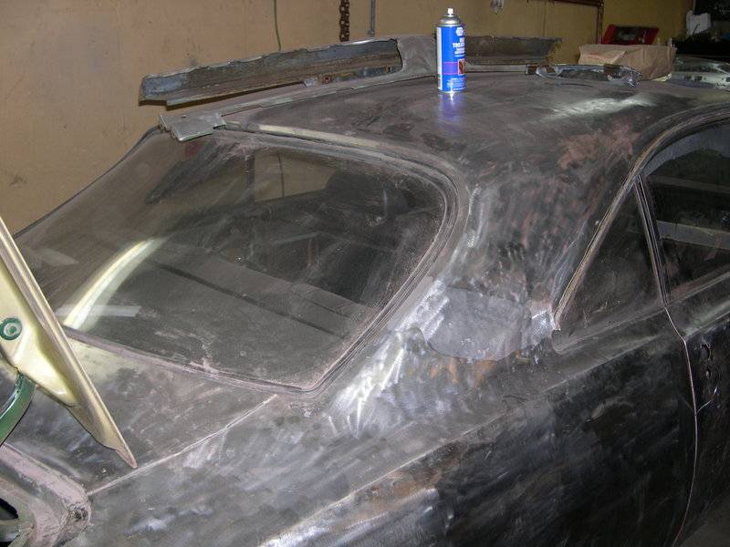

I ripped out the 340 and traded it to fellow member Moper in exchange for some work on a 340/416 Dart Sport I had at the time. The Barracuda had already been repainted on top of the original paint, so after the engine was out I began by stripping the engine bay down to bare metal and giving it a quick etch prime via rattlecan. Getting rid of the multiple coats of paint underneath what would eventually be gloss black could only help the engine bay look even better, with more defined edges and contours. At this point in time I also removed the rear windshield and installed a new Legendary headliner (via Dante).

In addition to the floor patches, I welded on new replacement/half quarters and trunk extensions, sections of rocker, replaced the doors with some rust free ones, and found a decent trunk lid and hood.

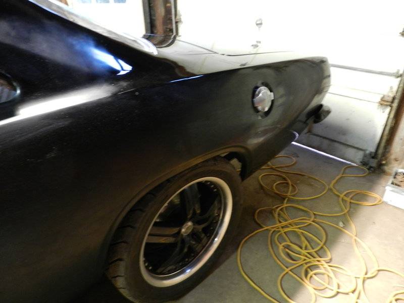

When I did the 1/4 panels I was a bit sneaky and slightly widened the wheel openings to fit the new oversized wheels and tires. This car would be sporting 275/40R18x8.5 rear, and 245/45R17x8 front, on some black & silver Rogue wheels from American Racing.

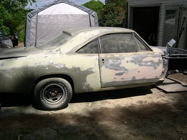

Here are some shots of the prep work fellow member "moper" did getting the car ready for blocking back in May 2007. Some of the new Legendary interior is visible, I reupholstered the seats myself after installing the new headliner.
When it rains, it pours - I was only able to pull a few more photos off the old hard-drive before it decided to give me the "click of death"
After the car was blocked we trailered it to an undisclosed location deep in the hinterlands of rustic CT for paint.

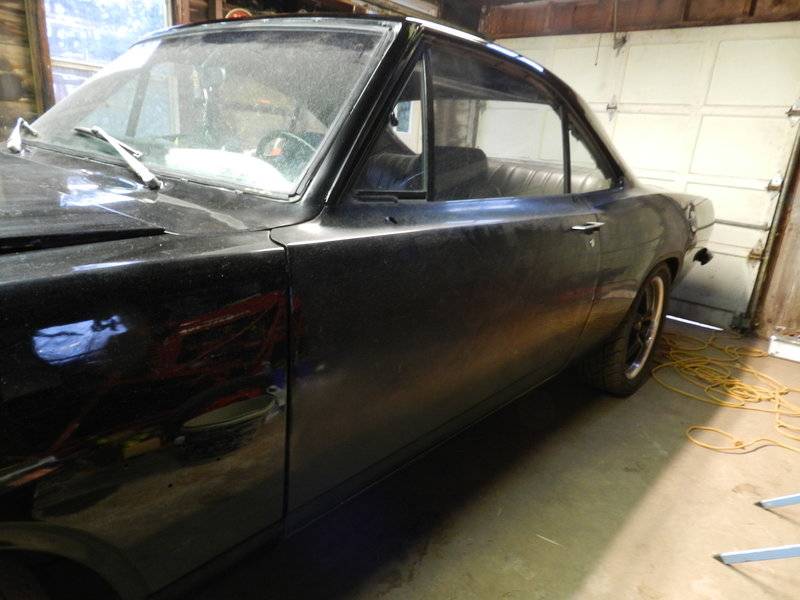

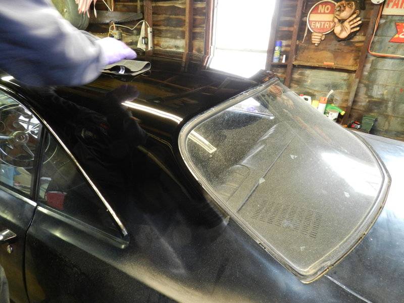

Got into the buffing yesterday with a friend. I had wetsanded the whole car around 6-7 years ago with 1500 then 2000 grit, back when he buffed the front clip (we will need to cut and buff the front again from all the scratches over the years).
After wet sanding some areas I touched up, he followed with a wool pad & ClearCut compound. Final polishing was done with an 8" foam pad and Meguiar's Mirror Glaze.
The roof and decklid are done, we are working top to bottom on this. Today's goal is to finish the top edges of the doors, redo the hood & fenders, then start working down the sides.
Carnauba wax will go on at the very end.
