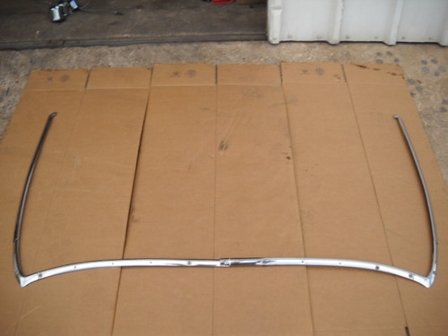

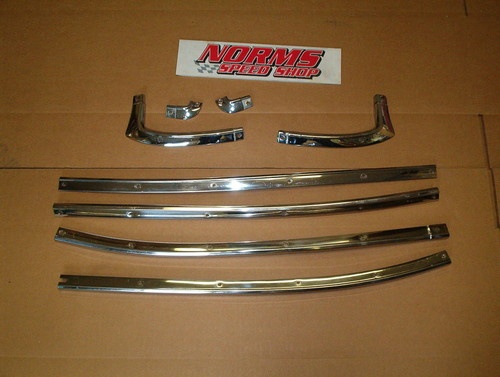

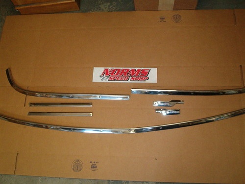

Make sure you get the right parts. In looking for a picture of the 1968 Dart Convertible trim I found the 1969 Dart and the 1967 Barracuda trim so I will post them for reference.
1969 Dart Trim Pictured.

There are many sellers that list parts as fitting wrong cars because they lack the knowledge of the cars. I have bought things that was supposed to fit my convertible that was wrong and many weren't convertible parts at all. To save yourself a lot of hassle and lost money, just make sure you always get pictures and match them to what you need.
Look at this auction and you can see it doesn't match both cars like it is listed.
1967-69 PLYMOUTH BARRACUDA DODGE DART CONVERTIBLE REAR BELT MOLDING TRIM
http://www.ebay.com/itm/1967-69-PLY...DefaultDomain_100&hash=item1e6fa34e5a&vxp=mtr

I don't know that the Darts are different from year to year between 1967 and 1969. That is a question you need to ask Dart convertible owners. The Barracudas is different from the Dart for sure.
dart trim is the same (67-69)-- there is 2 different versions of the pinchweld trim, 1 is pictured above where the trim stops at the 1/4 window. The other piece slides into a piece of stainless -- so the trim is across the 1/4 window & terminates at the door gap. Lawrence
what are you talking about? convertible or hardtop? convertible dart trim is the same from 67-69-- there is 2 different versions of the 1/4 window trim--- 1 style stops at the back side of the glass-- the other transitions at the glass & has a piece of stainless that slides in it & terminates at the door opening.
this is just the convertible items-- as for side trim & such I'm sure 68 is by its self as is 67 & 69-- there are a lot of 1 year only specific trim---

the photos show a 69 dart trim-- with the transition style molding,
the red car is a 68 convert--
please advise which item is 68 only that you are asking for -- as these 2 cars are using the same convertible moldings 1 is 1968 & 1 in 1969

Friend we are talking about to diffrent parts i need the pot metal parts very short and there is 4 of them :banghead:
look in post #3 right below the bumper sticker-- those are the pot metal pieces for a dart.
that set terminates at the rear 1/4 window( the small cut-off piece), the pictures I posted have a slightly different piece at that point.
Which style does your car have?
