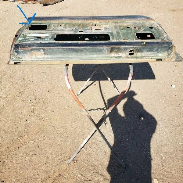

I'm looking for ideas on speakers and placement areas some have used in their Ragtops. I stole this pic of the web. Has anyone mounted speakers where the arrow is. With the door closed the speaker would get sound to the back seat area and if so, what speaker did you use.. I really cringe at cutting up my door cards and would like some other ideas. I used some Bose cube speakers currently but they are 8 ohm. really want 4 olm speakers. TIA

If you put speakers in the doors you risk interfering with the window rolling down, shallow speakers and spacer rings can help but honestly, not a great location... Your dart has vent wings so the area below that doesn't cause problems... Kick panels are shallow but I've seen replacement panels with a protrusion for speakers, the Dart has a pull handle E brake so you don't have that to worry about...
And I've seen shallow speakers mounted in a box and slid under the front seats..

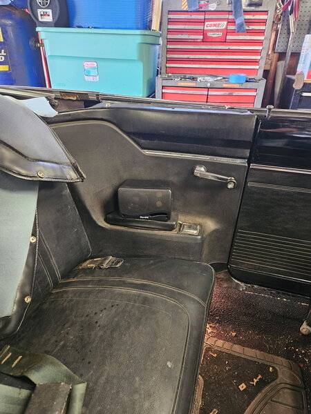

I just picked up these cheap box speakers.Velcro to the armrest. They sound ok. I also went back to the front kick panel speakers. I will pick up a set of the custom speaker kick panels. Just waiting on my 5 channel amp so I can add the subs in the trunk.
