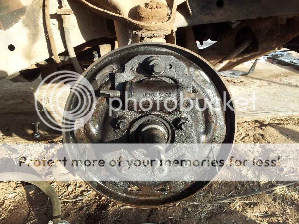

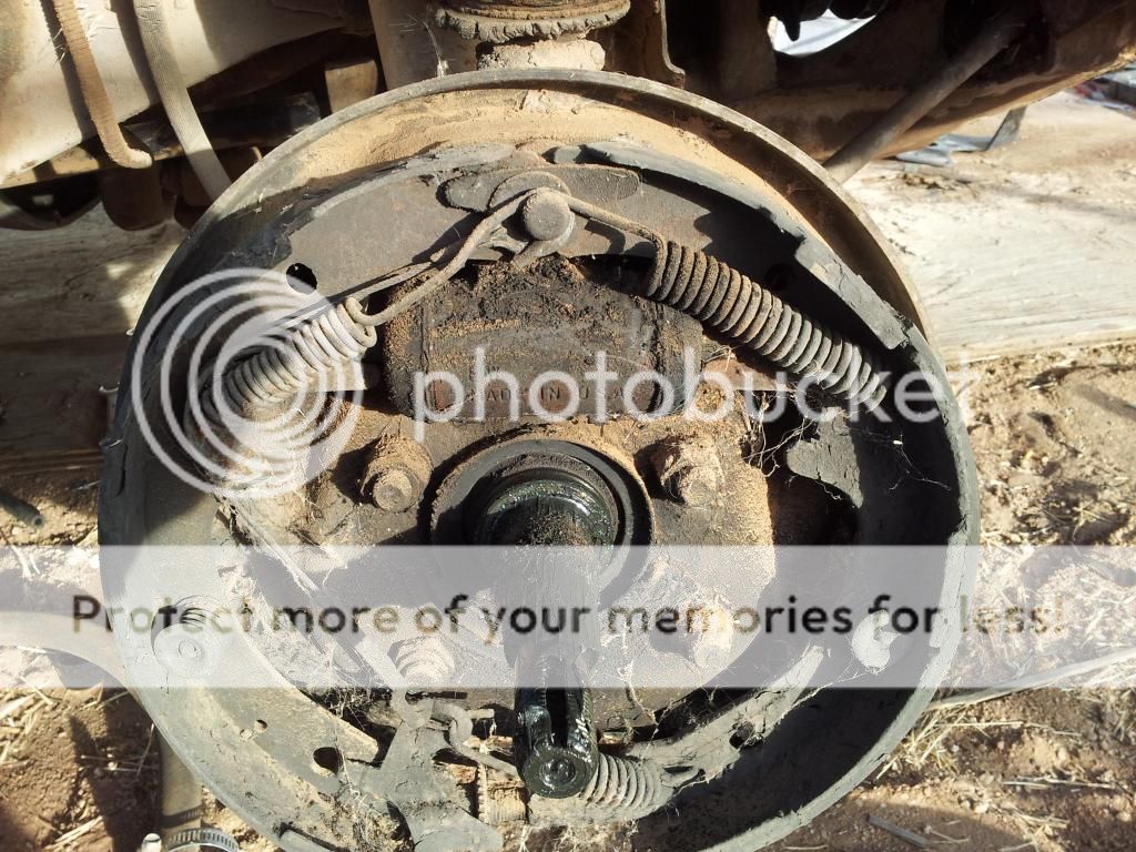

However i'm looking for sum information on Drums brakes first time working on this car alot of things are neglected not well maintained, installing new brake line along with Brake drums and shoes i'm currently stuck and i understand that Napa should have the correct springs for his car below is a picture on the cars engine in it's current state, Along with the brakes before and after i took the springs and shoes off i need a kit for the springs i believe i got the correct shoes size mostly cuz theirs only two options at auto zone and the 9's are to small so the car must use the 10's.

Should be able to get spring kits for them no problem. Try rock auto.com or even summit racing. I would really look at those wheel cylinders too, make sure they're not leaking. Let's see some pictures of the whole car.
Ian
The wheel Cylinders are toast all the way around along with the brake line. I didn't realize this site had to be approved by a mod and posted twice ops sorry op. yeah i was looking at Summit racing for a conversion kit for the brakes this was the best route at the time. i will look into it on there site thanks for sum information. napa wasent a option at least not for me i guess.
spazman1990,The part#s are H386 return spring kit,33507 and 33508 FT.wheel cyl. These are Autozone#s.However I would replace the wheel cylinders but I hate new spring kits China Junk I'd try to clean and reuse the OE. Mopar ones USA made way better than new!
