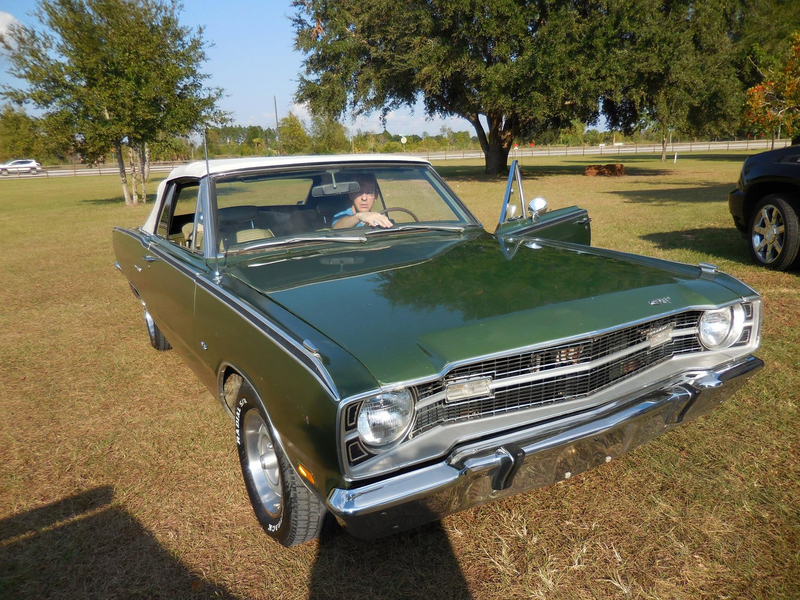

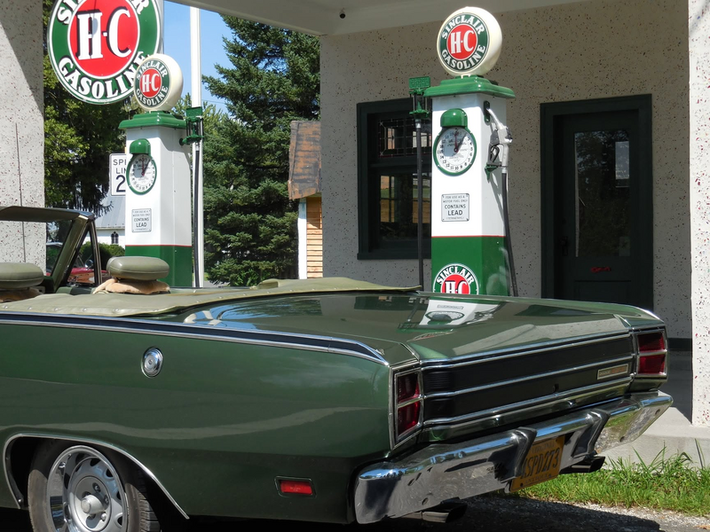

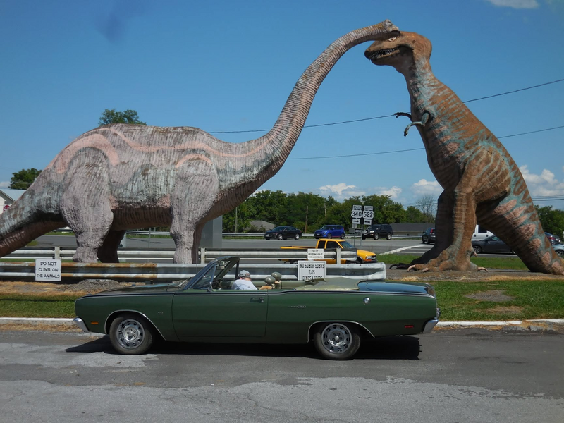

This is my buddy's 69 Dart GT. It wears the upper body side moldings that all 69 Dart GTs were built with.

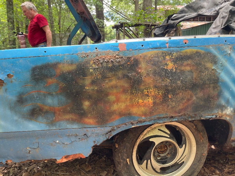

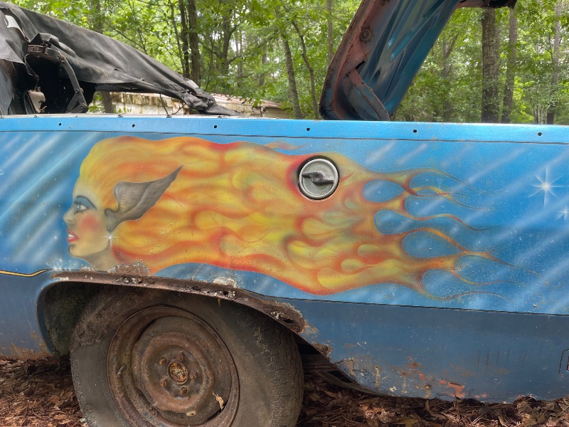

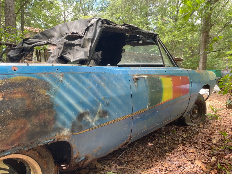

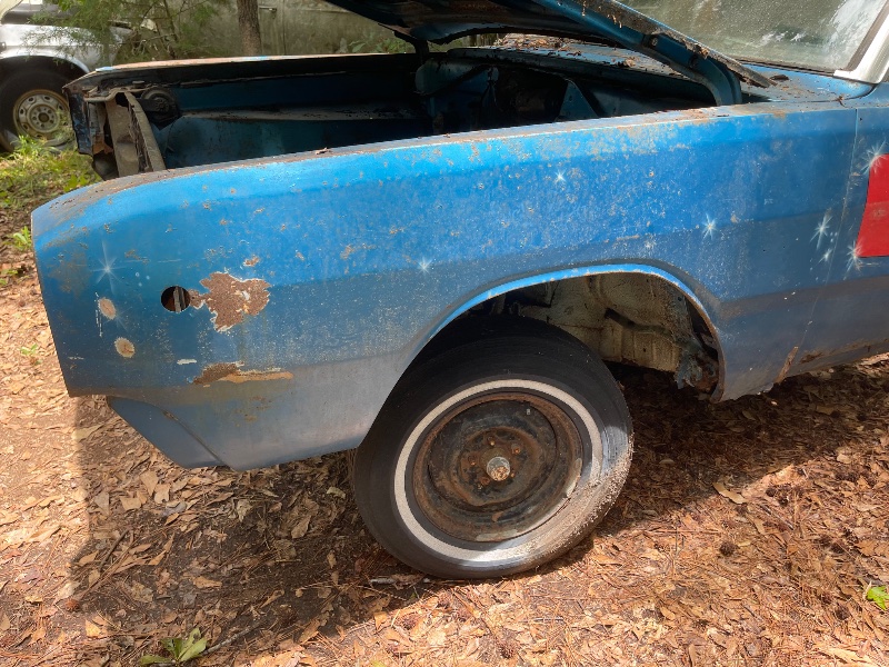

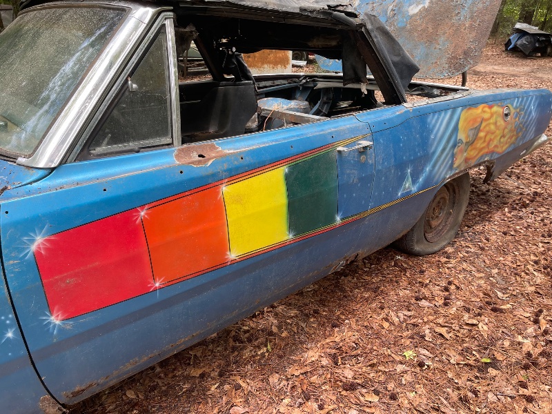

Pics of my car in current condition. Apparently it got customized in the '70's…
Anybody recognize this car? I'm told it came out of Wilmington, NC years ago. I picked it up in GA.

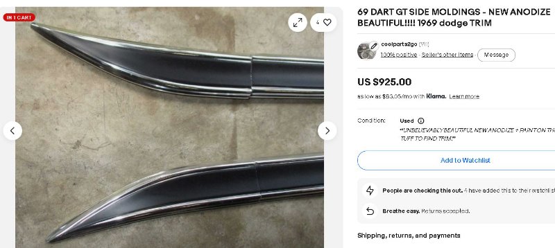

Anybody got a full set of '69 trim? Or a source? I assume this would be the same as the 2-door hardtop?

i bought a full set of trim for mine paid about $700 used ...maybe next year ill sell my old but its got some dents ....
If you think the trim is hard to find for a 69 GT wait till you realize you need the clips to put it on.
I have a full set of trim that will eventually go on my car, and a few extra pieces. It’s not common to see it come up for sale but I’d definitely give the wanted ad section a try.
