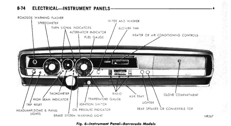

Check an owner's manual for the place the switch is supposed to be installed. This picture is from the '68 Barracuda manual and is what I used to locate my fader switch.

The few I've seen have been on the underside of the dash where it's easy to drill a hole and quickly install a fader switch. But to do a clean job, the dash bezel should be removed. That's not something a flat rate mechanic might want to do if there's a quicker, easier way.

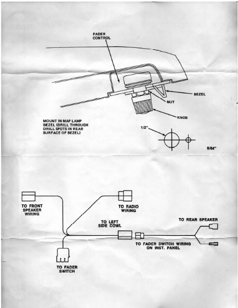

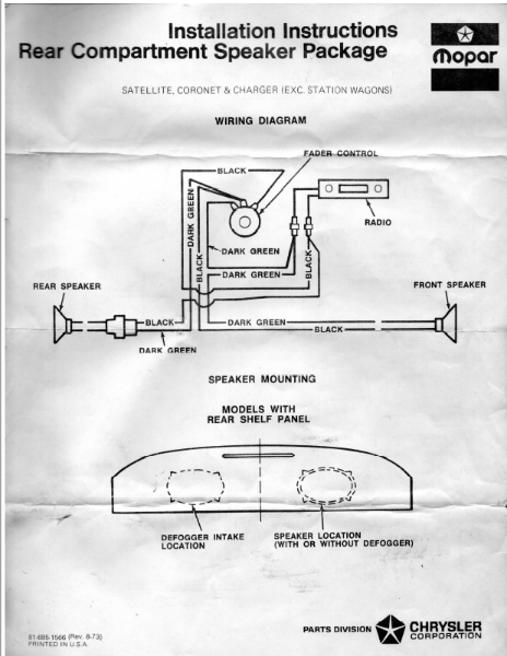

On the other hand, the speaker kit listed for the '69 Dart includs a grille and bezel. Maybe so it can be mounted elsewhere. If the instruction sheet could be found, that would help. I'm going to try to attach a later instruction sheet for B-bodies at the end of the post.

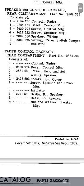

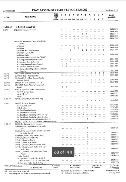

Thanks guys ! This is a big help....I did notice in the part book, it does call out a grill and bezel, so I'm not sure if that was the factory installation or just the accessory install.
