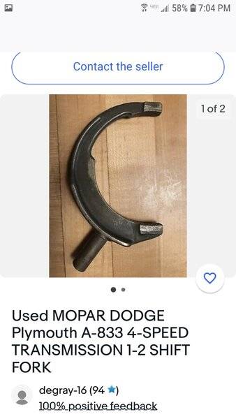

Bent shifter fork?

Check for wore out shift forks and replace them with new. Or do the old school fix and build them up with brass and re-machine them back into spec.
Quench shift forks in oil after brazing them to retain hardness.

With this info are you all inclined to go with the shifter fork or synchro hub issues?

>That Pistol-Grip is not helping. The heavy handle puts pressure on the detent spring, just begging it to jump out; you may have to increase the spring pressure.
The later style (71-Up) sidecover has a better system to deal with that.
>If it still jumps out of gear, with the 71-up cover; the trans will have to come out, come apart, the clutch teeth back-cut, and the slider cleaned up.
I have successfully done this dozens and dozens of time on A833s and hundreds of times in General.
