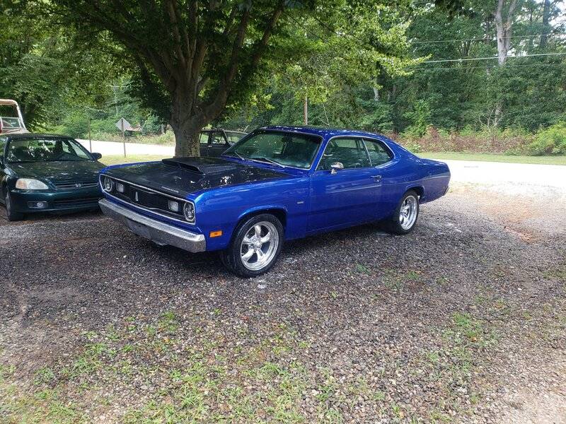

Sigh, so there is still an issue. I'm not sure if this one has been since start up or happened after. I didnt do a compression test before startup because I was excited. Never again. The car pulls pretty good now but there is still some blow by. Finally got around to a compression test and cylinder 7 and 5 are 80psi >.< the rest are 180. Machine shop had put the bottom end together again. And the shop is very reputable and have built motors for me before that get their *** whooped with no issues, so its not something they're doing.
This time I had a tune in the car from the sloppy tune cabinet and timing was way conservative at like 12 degrees. BUT a friend from sloppy did notice something. I'm running the round 585 coils and apparently their dwell time is supposed to be 4.2ms max. And holley defaults to 4.5ms. That can cause all sorts of hell with advancing the timing a ton on its own. Idk if that has been my issue all along but we changed that last night. Hopefully gonna have the motor back apart this weekend and see what happened.
On the bright side, I did get it aligned. And the engine bay looks pretty awesome lol.
Welp, got the motor apart this weekend and found the 2 broken pistons. Did a leakdown test first and 7 and 5 both had about 60% leak down, so I figured it was going to be the same thing as before and it was.

New pistons should be here this week. Hopefully this time around with the new tune changing the dwell I wont have this issue anymore. Went back and checked the data log and never built more than like 12psi of boost. So I can't imagine it was boost that hurt the pistons.
So! Updates! Got the 2 new pistons in and got the car running! The new dwell times seemed to have fixed the issue of popping pistons! This time I just pulled the pan in the car and slid the 2 pistons up out and swapped the 2 new ones in. The first time I broke the 4 pistons it also KO'd my main bearings. This time I didn't check them since I didnt pull the motor and was being HOPEFUL that being it only broke 2 pistons I was okay.
Wellll I got to drive the car a handful of times now! And man she goes good! And I'm ironing out some other bugs. Like the exhaust was SO drony in the car. So I added a muffler right after the downpipe. 4" doesnt belong under a car either. What a pain lol.
Anyways as I drove the car that handful of times I watched my oil pressure get worse and worse each time >.< and now its at 10psi and 0 when under throttle or hot basically. Soooo back off the oil pan comes and this is what greeted me .... sigh... lol so it seems that the detonation killed the bearings this time around too. I ordered new bearings and hopefully and just slide them in with the motor in the car still. Hoping the crank isnt damaged or anything. I have that 6.1 I'm building for this still its just much more money, so this just needs to last this season haha.

Welp, found the issue. It seems my thoughts were correct, the rod bearings were fine but the main bearings were wrecked. Luckily I caught it before it spun a bearing or really hurt the crank. New bearings will be here today and should have it running by the end of the week again hopefully!
that looks like fun.... not
That is really odd that the mains took such a beating. Usually detonation hammers out the rod bearings. Did you find a bunch of trash in the pan or oil pump pick up? This has me puzzled.
Yeah the oil pickup screen from the post above that one had a bunch of the bearing material in it. The rod bearings looked fine though!
Well the crank is trashed where the rod bearings ride. Junkyard 5.3 is going in it with my heads and cam while I finish the 6.1 I'm building. This motor was just supposed to be temporary but its been a nightmare while I worked out bugs lol. Hopefully I'll have the motor out of my donor rig soon.
