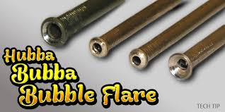

I used this on both my Darts. I used a brake flaring tool to put a (small) bubble on the ends so the line clamps can't blow off.
