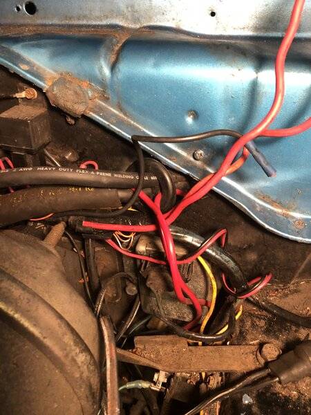

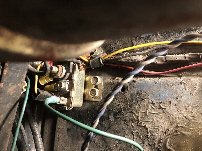

Ok let’s start with the middle picture. Ignore the 2 red wires pointing up to the right. If you look at the grommet you see one wire comes through it and turns down and it attaches to the bolt lug on the relay. On that same lug the other red wire come up and into a piece of hose that wraps around it and the main battery cable and the both go to the starter, one to the bolt on lug, smaller one to the plug on. The wire coming in went to the rear of the car where a hidden kill switch was so the car couldn’t be stolen. Both the main battery and the battery ground come through the grommet and go to the engine. As said before I would like to leave the heavy wire all the way to the starter. In my mind it makes sense to run a wire from the lug on the starter to the lug on the relay and all should be good. Thoughts?
OK one more time listen up Bottom photo
1...The big stud on top. This connects to BATTERY. It is HOT all times and NOT fused. It is also one of the relay contacts, and can be used as a junction point for "other things."
2.. Next one down the "square" terminal. This only goes one place: To the small terminal on the starter solenoid, NO where else and NOthing else connected to it. It should be large wire, no12 or no10
3 and 4. These are the magnet/ coil terminals and are what activates the relay. The yellow wire is "start" from the key, and the remaining one "depends." It does not matter which of the bottom two is connected to which terminal
The last of the bottom two depends on whether it is a stick or automatic. On older stick cars this terminal does not exist and is grounded by the construction of the relay. Starting in 70, with stick cars, this wire goes to the clutch safety switch. All cars with automatics this 4th terminal goes down to the transmission, to the center terminal on the neutral safety switch. It is grounded by that switch in park or neutral.
And yes my wiring is a mess. Wish I had a Mopar expert for an hour. It had dealer installed cruise control, dealer installed under dash ac with the controller on the drivers side of the dash just above the e brake lever so I don’t want to go wild cutting non original wires. The original wires are still bundled nice and tight in their original wrap.
