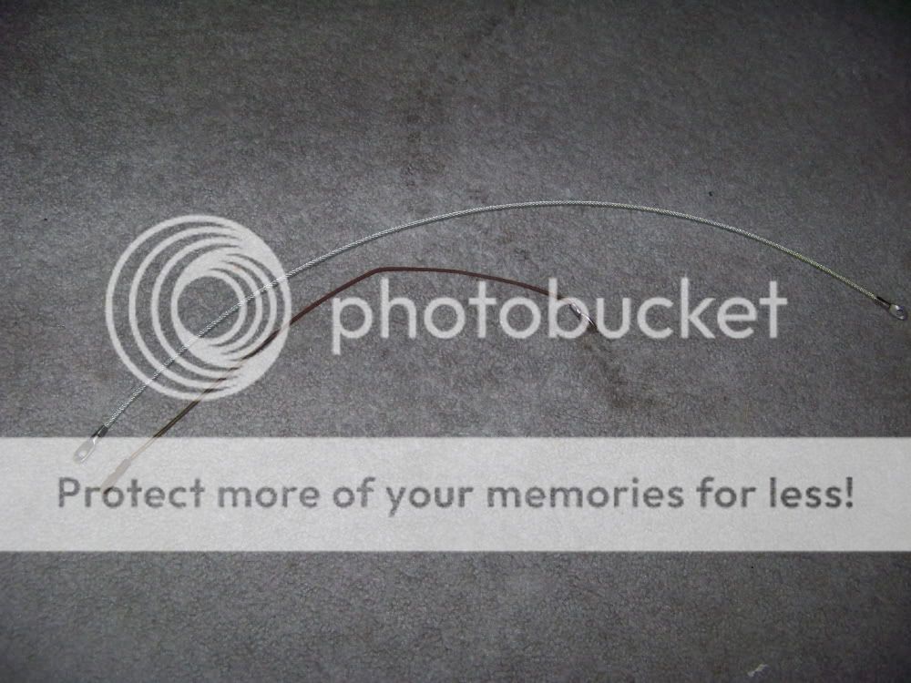

i found my original ones off my 71 duster u are correct i thought they were longer wen i bought them and i have seen the 23 inch lanyards on duster b4 and thought they looked too long and not right but here is a pic of my original and the new... original 13 inches repo 23 inches and about twice as thick... i dont know maybe i'll switch em' for shorter if it looks stupid

I bet 23" is correct for Darts and dusters are 18"? Darts have fender extensions so they are a bit longer in front.
Ryan, I had to go dig mine out, they are 13" also. I tried to upload the pics on here but for some reason ??? even after re-size I couldn't.

have u tried putting the 13 inch one on there how does that look?? the 13inch seems like it might be too tight

Ryan, I took the 13" off the car because as you can see in the pics, the plastic cover had dried up and was falling off. I didn't want the bare wire rubbing against the paint.
The 13" did fit fine, not too tight, and for sure not a pile of loose lanyard flopping around.
Giles
i might contact the people i bought them from and ask for new ones,,, or probly cut the ones i have down to the correct length
