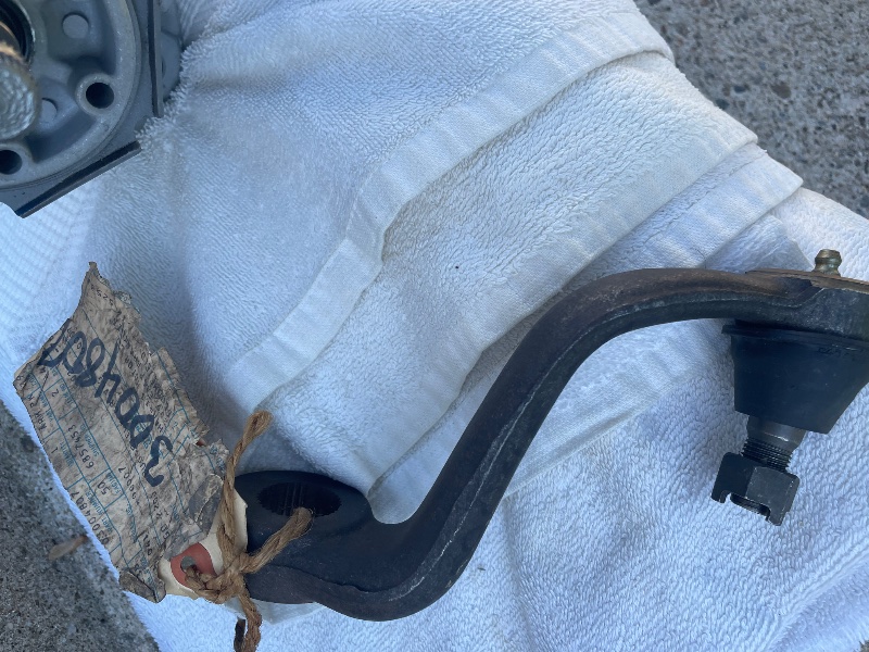

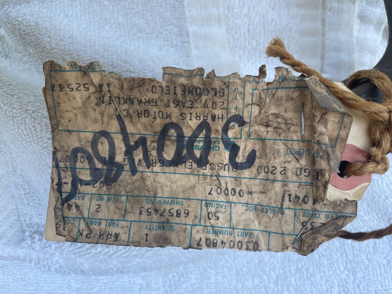

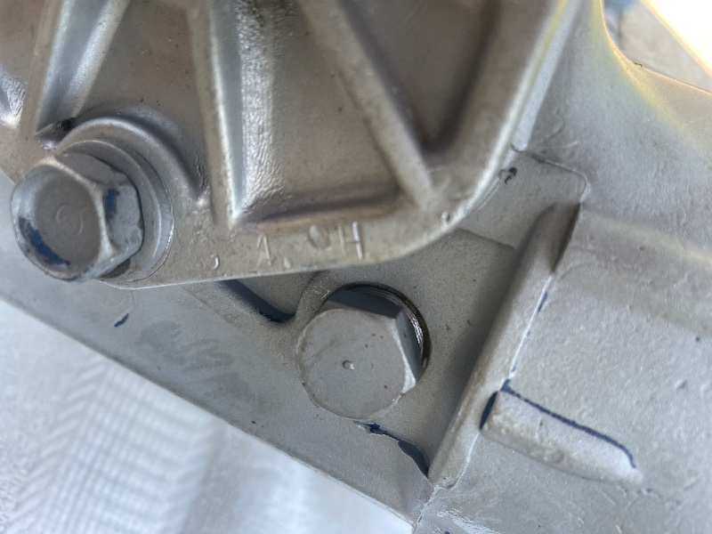

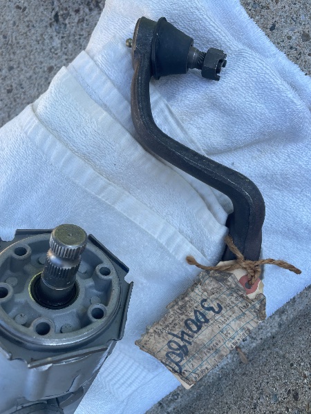

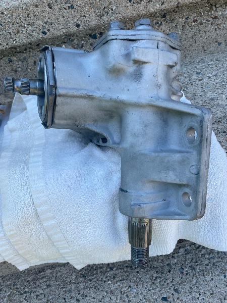

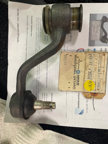

NOS front end parts going on! Dated & rebuilt original steering box by Steer & Gear in Ohio.
The NOS idler arm actual had surface rust, so it is in the evaporust.
